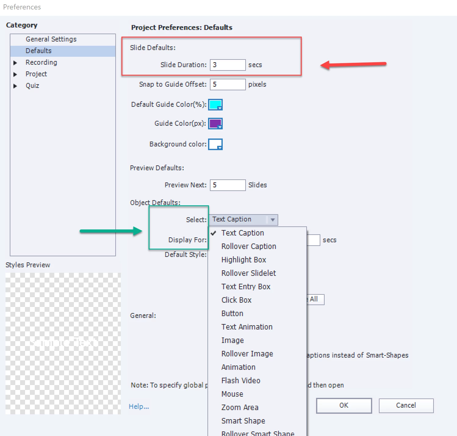

Not sure you want to increase the default slide duration, try first to understand how tCaptivate's Timeline is functioning. You can find the setting of all default durations (not only slides, but also for objects) in Preferences,  Defaults
If you insert an object on a slide where you have increased the duration to 5 seconds, the object remained at 3 seconds, you'll have to edit the object duration.
