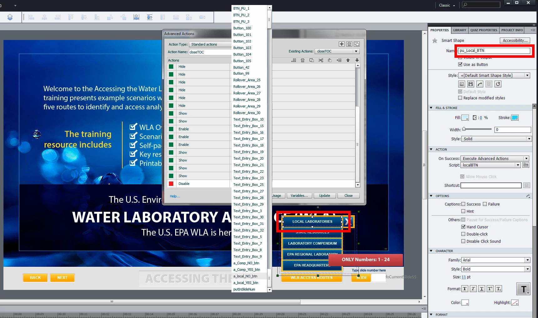

I have a project, Captivate 6, with a popup menu...I have the popup menu set to HIDE On Enter slide...but for some reason, when I click on a menu item and get to the destination slide, the popup menu IS HIDDEN, but the places where the buttons are IS STILL creating the click sound as if the popup menu is still up..but the clicks don't execute any type of action...just the click sounds on the areas where the buttons are...it's driving my client crazy and I've been trying different things and I just can't seem to get rid of it...
My popup menu is a group of Smart Shapes used as buttons...so they don't show up as an item that can be DISABLED in the Advanced Actions panel...even more peculiar however, is that the button I use to close the popup menu gets rid of the click sounds, i.e.- if I reopen the popup menu and close it with the close popup menu button, the clicking stops...what gives?
Isn't hiding an object virtually the same as disabling it? Any help on this would be just awesome! Thanks.

Hiding used to be disabling buttons in the past. For shape buttons it is not the case, you have to disable AND hide, or Show + Enable. It is very annoying, and I would appreciate if you logged a feature request to get back to the situation with normal buttons in previous versions (it is still not changed in CP9).
Another feature request, which I also logged a couple of times, is to be able to Disable a group of interactive objects, like you can Hide them. Not many users need this probably, or estimate it useful like I do. I understand Rod's arguments totally, he is a programmer. The easiest way would be if Hiding would automatically disable, and showing an interactive object would enable it.

Lilybiri, Rod, thanks for the replies...and yes, disabling/enabling would be the answer...but my buttons however, as displayed by the image, DO NOT SHOW UP in the Advanced Actions dropdown when DISABLE is selected...so, disabling IS NOT an option that's available...which is why I sought help...
I was hoping there was something I was missing...I knew I had to disable as soon as I realized the popup was the problem...see, I have some YES and NO buttons in the training that kind of occupy the same location...and for days, I was convinced they were the problem and tried everything to fix the problem from that vantage point...of course when nothing worked and I removed the YES and NO buttons from the timeline and still had the problem, it didn't take much to realize the popup menu was the problem...which while hidden was still LIVE really kind of threw me.
I'm guessing, from you guys have said, I'm going to have to rebuild my menu using custom image buttons...this button type will show in the disable list...yes?...I used the Smart Shapes because they allowed me to actually use text for the labels...the image buttons are just so susceptible to distorting when viewed at less than 100% view size...
It guess if I could change the X and Y coords to something that was outside the viewport as the default state, that would keep me from having to rebuild it...there goes my weekend
Well, I'm going to Save As... and get to work on the rebuild...I'll still be checking email in case you guys put the light bulb over you head over my head...I think I said that right.
And yes, Lilybiri, GOOD feature requests...and cool would it be if I HAD THEM NOW...I'll log them as well, thanks!

OMG, what a list! You never heard about labeling and filtering in a list based on a sequence of characters? With grouping, those are labeled TopTools in my cookbook about Actions that I'm preparing at this moment.
I suspect the sequence is wrong in your advanced action: you first have to disable before hiding. Same for Show before Enable.
RodWard
September 19, 2015
Even if you HAVE grouped the buttons, they should still appear somewhere in the Advanced Actions dialog objects list by name.  (Unless you placed them on a Master Slide.)
Try renaming these buttons to something that makes them sort to the top of the lists.
Also, if you have set this group of buttons on an earlier slide and timed it for REST OF PROJECT, then you will not see these buttons listed in the Actions panel drop down, but you should still see them in the Advanced Actions dialog.  So you may need to be creating Standard, Conditional, or Shared actions to manipulate them.
Also, when you HIDE these buttons, you also need to DISABLE them as well, otherwise their hit areas could still be active, which might account for why you're still hearing clicks.  Then when you SHOW each one, there needs to be an equivalent ENABLE action for each button.  I would suggest since you need to be dynamically hiding and showing this group of buttons you may need to forget about the grouping strategy because although you can HIDE and SHOW a group of objects you cannot apply DISABLE and ENABLE actions to anything other than interactive objects, and a group is not an interactive object.
