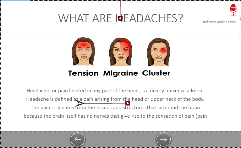

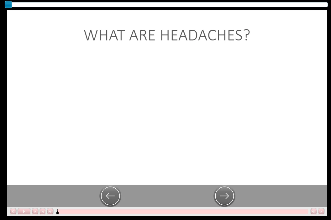

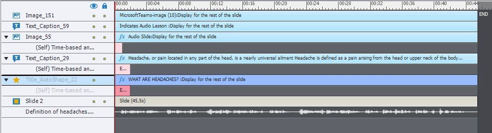

    Here are some screen shots:
    Slide content:
    Timeline view:
    Online preview result:

    There is also something weird happening with the skin editor, where even though the audio is playing,
    the slide seems to be paused, and the "play button" is showing, not pause button; the slide duration is
    45.5 seconds, but the slide is pausing after about 1 second?
    The client has some buttons on the master slide, and some buttons on the actual slide itself - not sure
    wether this has something to do with it?
    Clicking the play button of the skin editor makes the back and next buttons on the slide disappear...

    Lilybiri
    Sep 30, 2021 9:28 AM UTC
    You are using Fluid boxes but not consistently. In the Timeline screenshot I see that only one item is IN a fluid box (Title), all the other objects are not in fluid boxes. Why? Did you set those up with Position Properties?  That would be weird, because in that case I'd recommend to use Breakpoint views instead of Fluid Boxes.

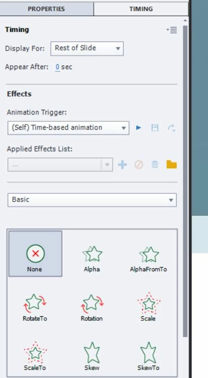

    erynb45991075

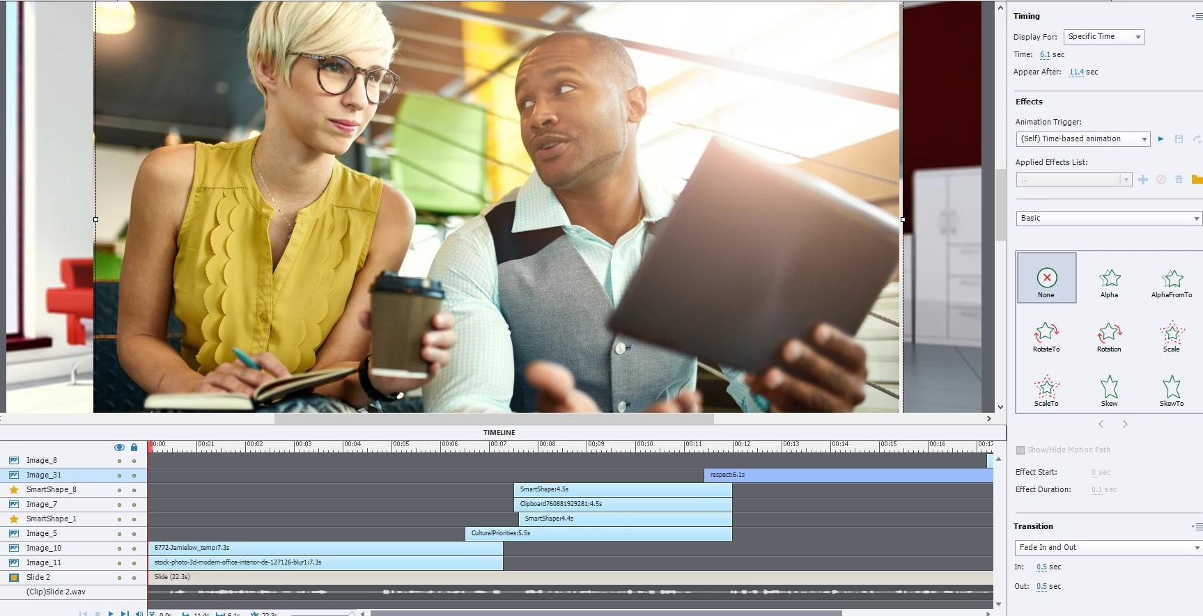

    Dec 5, 2016 7:07 PM UTC
    Hi Lilybiri​. Further question. Those items that are paused do not correspond to the objects that are not showing up. When I previewed, the objects show up. When published as an HTLM, they do not show up. I am not sure what is going on? Possibly something with the state view? I am attaching two screen shots to give an idea. I cannot seem to turn OFF the animation based trigger. Possibly that is it? If so, how do I turn it off? I try to unclick it to no avail.
    Lilybiri
    Dec 5, 2016 7:15 PM UTC
    Please, can you find time to read this very old blog post:
    Tiny Timeline Tidbits - Captivate blog
    How did you 'Preview'? Today already 4 users have been warned that Play Slide is NOT a preview method. Best Preview method in your case, since you want HTML output is 'Preview HTML in Browser'. If everything works correctly there, it probably will after publishing.
    The first of the two objects which you selected is a webobject, right? Can you upload the published version to a webserver to see if it works? If you have published as a SCO, you need to upload to SCORM Cloud for testing.
    The second object is an image. Can you check in its properties if it is visible in output? You posted a screenshot of the Timing panel, I can only see that no Effect is applied to those two objects.

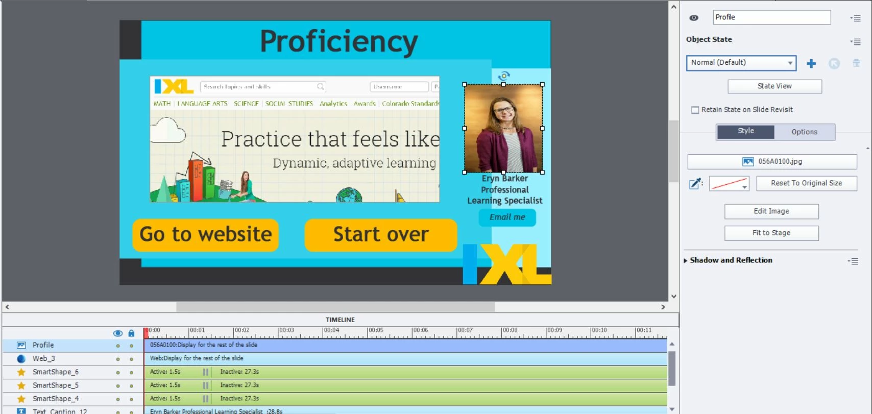

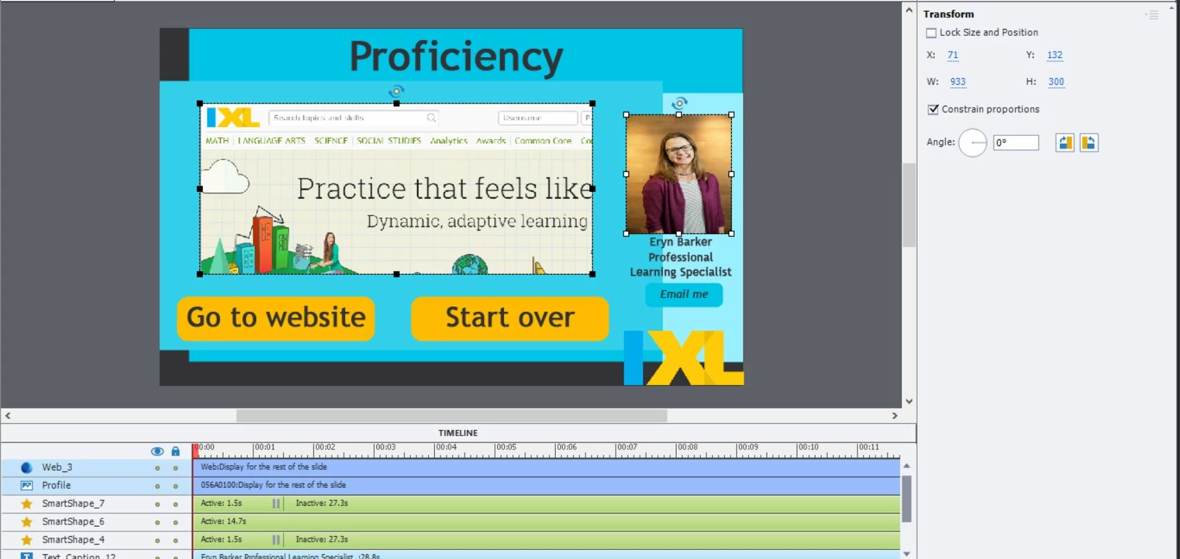

    erynb45991075
    Dec 2, 2016 4:08 PM UTC
    Thank you for your help, RodWard! Those smart shapes are buttons that ARE appearing in the htm publish. I am sharing a screen shot of the timeline including the picture (labeled as profile) and the webpage (labeled as web). Any ideas????
    Thanks in advance for your help!!
    Lilybiri
    Dec 2, 2016 4:53 PM UTC
    Rod answered this question (you seem to have two Adobe ID's?): the slide is pausing at 1.5 secs because of thsoe shape buttons. I don't see any objects coming in later on, but the timeline panel is only partially visible on the screenshot. If there are objects timed to appear after 1.5 secs, you need to move the pausing point of those shape buttons: either drag the pausing on the timeline or use the Timing Properties panel.
    RodWard
    Dec 2, 2016 3:57 AM UTC
    Is this HTML5 output?  IF so, upload to a web server and test from there.

    RodWard
    Dec 2, 2016 5:25 AM UTC
    Are you sure they're not just failing to appear because you have interactive objects on the timeline ahead of them set to pause the timeline?  These objects don't pause the timeline when you just do an F3 preview to play the slide in edit mode.  But they will pause the timeline at runtime.
    Let us see a screenshot of the timeline of one of these slides where the objects don't appear.
