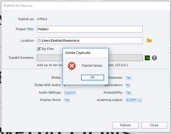

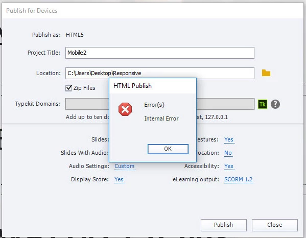

I am trying to publish a responsive course and get the below messages. There are no special characters and Show Playback Control is checked. I'm not sure what I can do to correct this error. My file only partially publishes. Any ideas?

Sometimes there may be something on one or more of your slides in the project that will be causing the publish to fail.
To isolate where the issue is located, take a copy of your project to use for testing, and hide different groups of slides before trying again to publish.  If by hiding some group of slides you can now get the project to publish, use a process of elimination to find the slide where the issue is located and then go through that slide dragging one object at a time into the scrap area before republishing again.
If this is the issue preventing you from publishing then eventually you should be able to locate the offending slide or object.

I just had this happen to me yesterday and I can confirm that RodWard's technique actually helped me with this issue.
Apr 30, 2019 7:40 AM UTC
Kind of a specific scenario maybe, but...
I noticed that I get such errors when during an attempt to publish a project I have the target location open in Windows Explorer. Closing the Explorer window, or just navigating away from the target path fixes this.
Lilybiri
Apr 30, 2019 7:45 AM UTC
That is indeed a weird solution....but if it works.
Apr 30, 2019 12:18 PM UTC
Sounds like your system is putting a file lock on the open (visible) location - like trying to save a file in an editor when the same file is open in a viewer or other application. Good you found such an easy fix, though.
