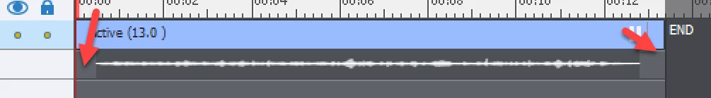

Hi there, I want to bring up this issue because Im having it right now..
I have 34 audio files in my project and just 14 after publishing, when I navigate the course secuentially it is fine, but when I use TOC or goToPreviousSlide action, it is a mess.

Sorry, I don't visit this subspace as regularly as the rest. Since you posted this in a very old thread, I branced (not as sensei but as moderator) to a new thread.
Problem occruse because your audio clips start on the first frame and end on the last frame of slides, which makes Captivate think it is one audio clip distributed over multiple slides.
The solution is manual but simple: leave a small gap before and after the audio timeline on each slide.
