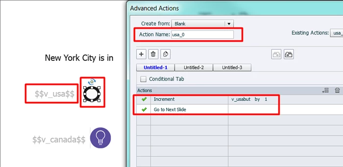

    Slide1 -- Create the question eg:
                   New York City is located in the
                     USA (create a text_caption, create a variable  v_usa, value equal to USA, attach the v_usa variable to the text by using the
                             Insert variable )
                          Next to USA  create a smart_shape, use as Button,
                          create a variable name v_usaBut, value equal to zero.
                             under Actions On Success: Execute Advanced Actions
                             Script: give the script a name, First Actions -  Increment v_usaBut by 1  , Second Actions - Go to next Slide
                    Canada (see above)
    see image:
    Slide2 -- (create a text_caption, attach the v_usa variable)
    If you are using image, the same image must be slide1 and slide2 but using different name.
    Additional info will be provide later if needed.
