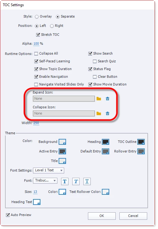

    You can follow Rod's instruction to replace the images, then execute this JavaScipt on Slide enter of the first slide
    var tocBtns=document.getElementsByClassName("tocExpandCollapse");
    tocBtns[0].style.width="100px"
    tocBtns[0].style.height="100px"
    tocBtns[1].style.width="100px"
    tocBtns[1].style.height="100px"
    This makes them 100 x 100 px;

    Yes there is an option in the SKIN Editor to change the images used for the TOC Expand and Collapse icons.
    However, be aware that there are quite strict limitations on how big those replacement icons can be.  They need to be almost exactly the same size as the existing ones.

    I will often create a toggle button at the bottom to open/close the TOC.
    The default buttons can be made transparent, you can replace them but not increase the size.
    Recently I blogged about a shared action for such a button, for CP9. You do not have states in 8 but same can be achieved with show/hide.
