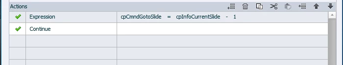

With my Replay button, I am able to go back to the beginning of the slide with an Advanced Action like this:
But this only brings me to the first frame of the slide and does not trigger the slide's On Enter Advanced Action again, meaning that the Javscript for the timers are not triggered again, which would reset the timers for me.
