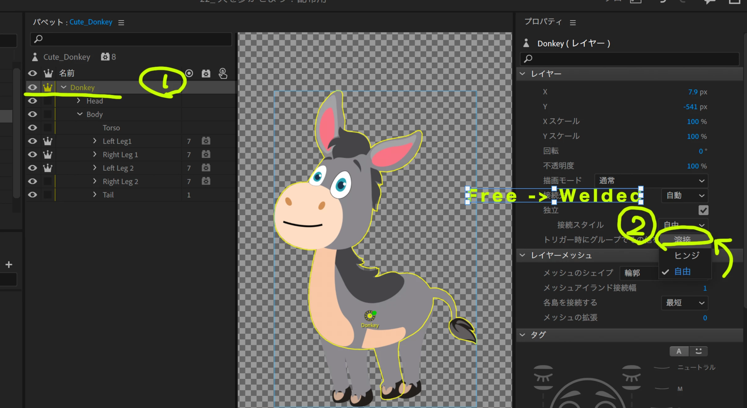

Hello everyone,
Even though I made all the adjustments, 2 legs of my puppet are floating in the air, and the other 2 legs, which are fixed, start to slide after a while.
Can anyone help me on this?
You can reach my puppet from the link
Thank you from now..
https://drive.google.com/file/d/1WpNvQwv6wRVjlR4Gqg6hrDGZpt_bQLB7/view?usp=share_link

The connection of the top layer.
(1) Free -> Welded
2) Hip tags were attached to the base of each leg.
3) Removed hip tags from the torso.
4) attached the IK of the limbs to each foot.
5) Removed drag tags from the toes of the front feet and moved them to the heels.
Thanks.
https://drive.google.com/file/d/1oXmsQLX_REpkUCE1XAZ925s3VjLWo1aX/view?usp=sharing
https://youtu.be/2hwPidYbHEs

Mr. Oshiro, thank you very much for your answer.
This answer will be a guide for my other 4-legged characters,
I wish you healthy days..
