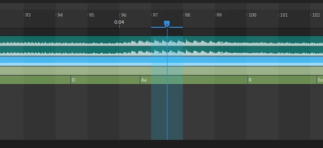

I have a puppet, which I created about two years ago and it worked just fine. Now I wanted to reuse it, and when I make the Lip sync form audio track, the Aa mouth move doenst show up. Any ideas, where the problem might be? I've attached the puppet to thias post.

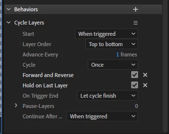

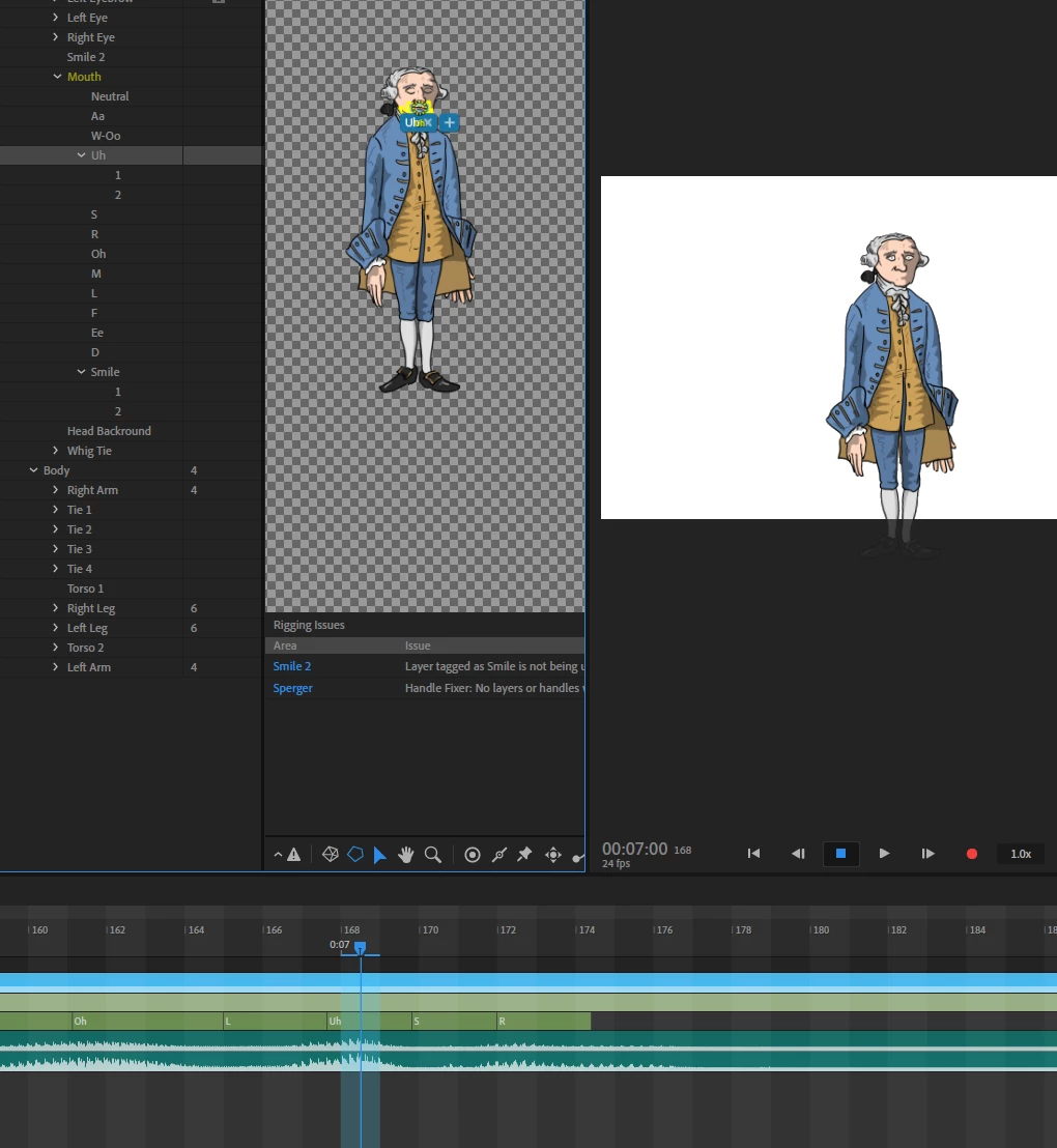

Ah, I see the issue. You have a group with 2 layers tagged "Uh", but everything inside has the eyeballs turned off, so when it's triggered, you're basically triggering nothing. There are 3 fixes:
* Add the Cycle Layers behavior if you intend for the Uh viseme to be a series of layers. In this case, make sure you set "hold on last layer" and "stop immediately.
* Delete the group and make your Uh layer just like your other visemes
* Turn an eyeball on for every layer you want visible when LipSync triggers the Uh viseme.

Thank you very much, that was obviously the problem. As I am in a time pressure, I just simplified the cycle visemes to a single layer and it works just fine now 👍

Thank you. I used CH Beta and I synced the puppet to an audio track I had available. The Aa Viseme is showing up fine. I did notice that the Uh and Smile mouth parts were set up for the Cycle Layers behavior which I implemented. I'm not sure why they were left off the puppet, but it was an easy fix, and for all I know, that fixed it.
