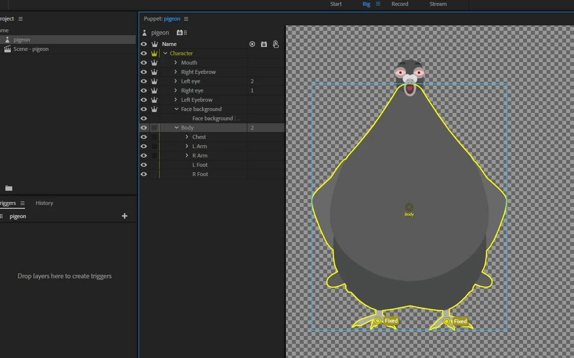

I am really sorry to bring this same thing up again, but I just cannot figure out how to make this thing work. I have been trying to pin this character's feet on the ground but I just cannot do it. First of all, when I choose a layer I get a yellow line around the character instead of only that blue frame I see in tutorials. I don't know why this happens? I wonder if this is related to the problem? So how to choose the "body" without the yellow line appearing?

    Hi. This is what I did to your puppet:

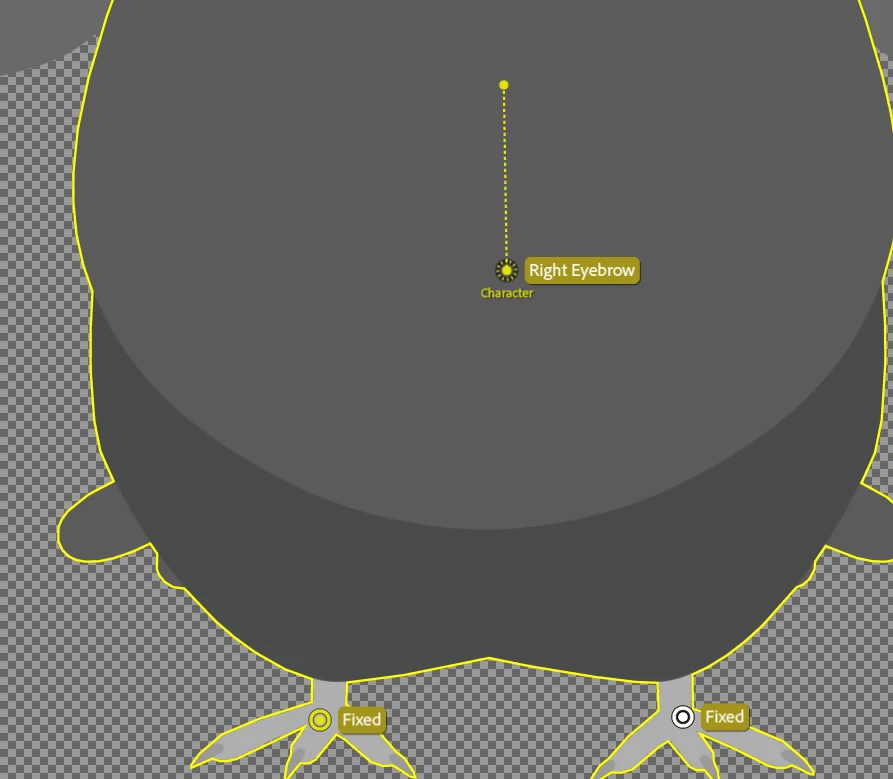

    • I clicked on the root "Character" layer and added "Fixed" pins to the feet. It still moved around a lot.
    • I removed the "Right Eyebrow" tag from the root character origin. I think that was causing problems. Eye movements would move the body causing issues. (Use the "Tags" panel to remove it. I like clicking on the "A" button (top right) to show text names for tags - makes them easier to click for me).
    • I then removed the independence crown from "Face background". The helped join the head to the body.
    • In the "Face" behavior section on the side, I changed the puppet's "Head Position Strength" from 100% to 400% - the head is so small compared to the body it would not move much
    Things started working a lot better then. I think it was the stray "Right Eyebrow" on the character origin causing you most of the problem.

    First thing to try - click the refresh button on the scene (there two arrorws in a circle in bottom left corner). That flushes some caches. It has solved a few wacky problems.
    I think you need to click on the root object in the independence group. That is, in your case, don’t put the pins on “body” (it is not independent - the crown is not clicked). Select the “Character” layer at the root and put the pins there. I think that will fix it. That pins it to the root (the scene) rather than the parent layer of Body (which is Character).
    I would suggest putting all the facial stuff under a “Head” layer (sibling of “Body”). Do you want the head to move Independent to body? It is fine to NOT turn on the crown for the Head layer, but all the eyes etc can then attach themselves to the head properly.
    In newer versions of CH there are now two buttons in puppet view - one shows the mesh (lots of yellow triangles), the other shows the outline only (yellow outline) but you always now get the blue “bounding box” - a rectangle around everything in the layer.
