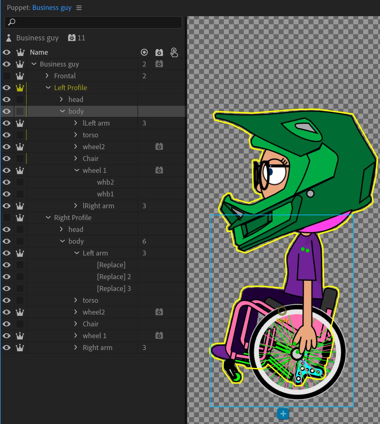

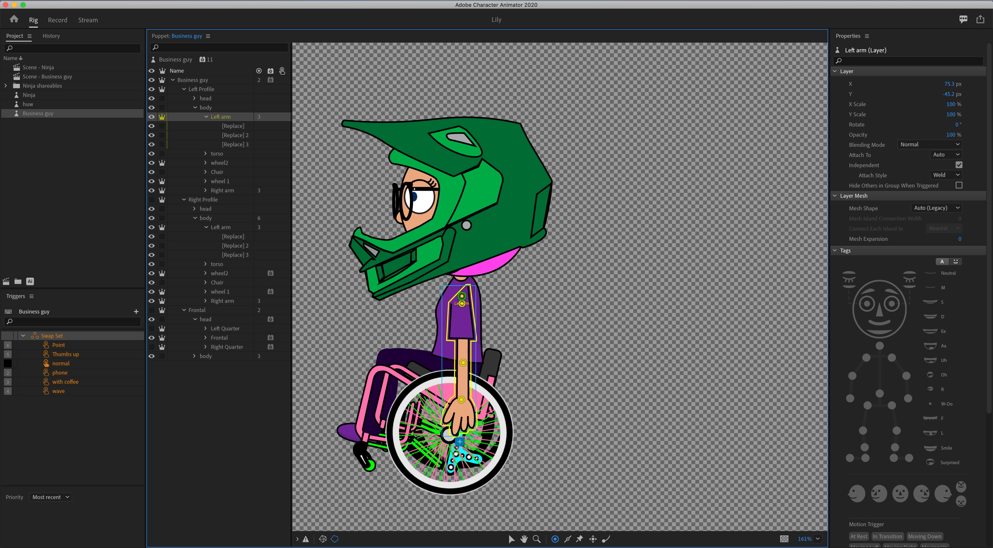

I have a 3 profile puppet built using the "Business guy" as a template. however when I try to add arm tags to my left profile.(having added them to frontal and right profile) it no longer works. when I remove the tags, the left profile appears again when pressing left arrow key again.

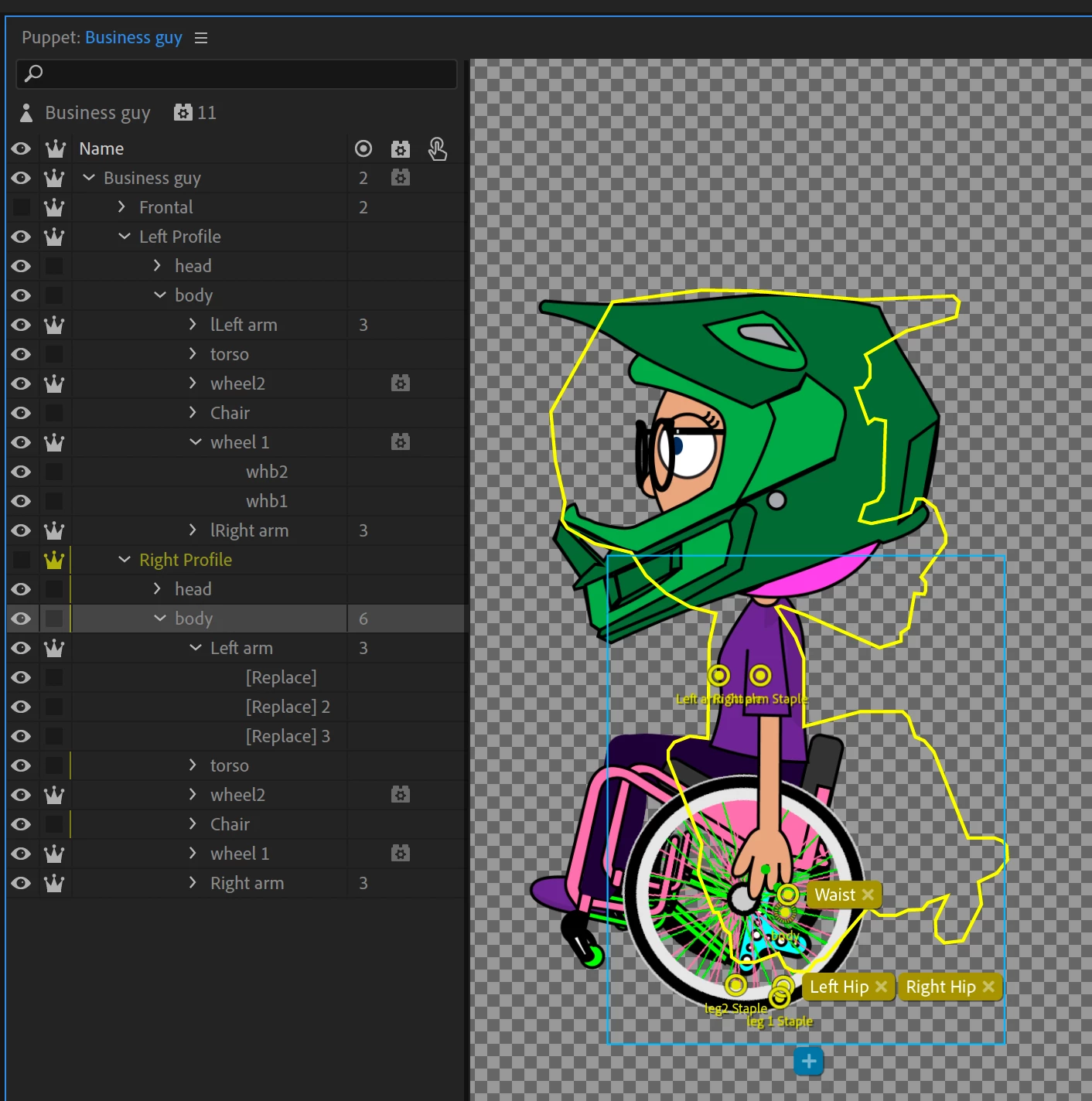

First, my understanding is it is best to make the Frontal profile the first sibling. I thought the Walk behavior assumes the first child is the non-walk profile (it does not look for "Frontal"). So I think some problems can occur if the standing profile is not first.
Next, in the Properties panel, have a look down the bottom of the Walk behavior. Expand the "Views" and "Handles" sections. In Views you should see two - Left Profile and Right Profile. (Remember standing should be first - it will no appear here.) You can also peek into Handles which will show all the wrist, leg, etc handles needed by Walk for the profiles it found. (Not needed for the standing profile - just Left and Right.) I would see if anything looks strange in here, and see what changes when you add the extra arm tags. It might give you a clue to the tagging problems you are having. I suspect unexpected things are being bound to.

Hi, Thank you, I have now noticed that my left profile does not have left and right arm staple on the body. also when I add points for shoulder elbow and wrist, they are only able to be attached to the body rather than the shoulder points etc like the working views. So it appears the left profile is not "bound"? how might I do that?
Also, I see the shoulder points are green on the left profile. not sure what this indicates. but is obviously related.

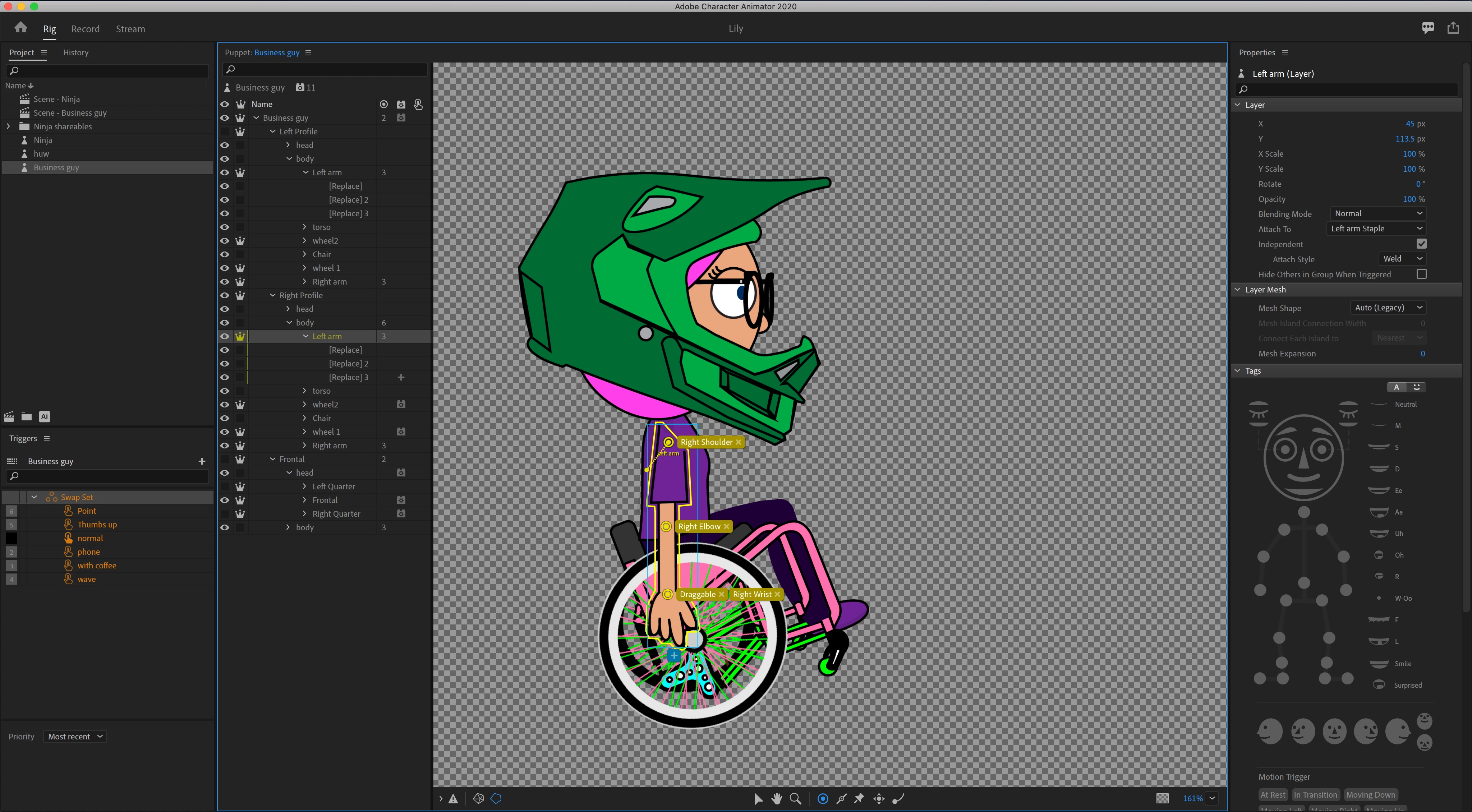

I have now started to try and rig the puppet from scratch and am having a similar issue. as soon as I try to add tags to the arms. that profile does not work. Waist and neck tags take effect. but the moment I put and elbow or wrist tag on the arms. the profile no longer works?
