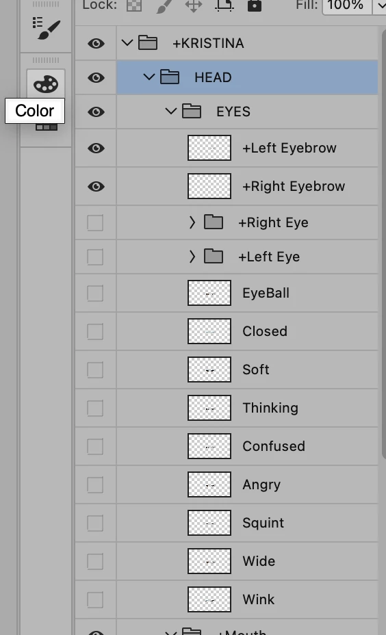

    Apr 13, 2021 9:24 PM UTC
    I see in the EYES you did all the emotional expression with the EYELID TOP/BOTTOM then EYEBALL TOP/BOTTOM
    I just have mine as the whole eye with the expression. Can I do this also... keep it simple since I am working in Photoshop. I may try to recreate this is AI but I have already done some much of this in PS.
    Please advise.
    Then how do I make this work...I am reading your post right now.
