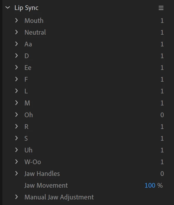

Can you bring this up in the properties panel? I clicked on the puppet root, found the Lip Sync behavior, then expanded this section. For my puppet, see how all the numbers are "1" (and some "0"). With your different emotions, you should see the count equal to the number of emotions.

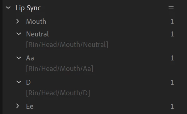

If you expand one, you should see the path to the layer for the viseme. Is it showing the path per emotion choice? Here is example of it posted with only one mouth set.
If it is not finding them all, you may need some more Mouth tags or similar. One thing to try is to add a Lip Sync behavior per mouth set.

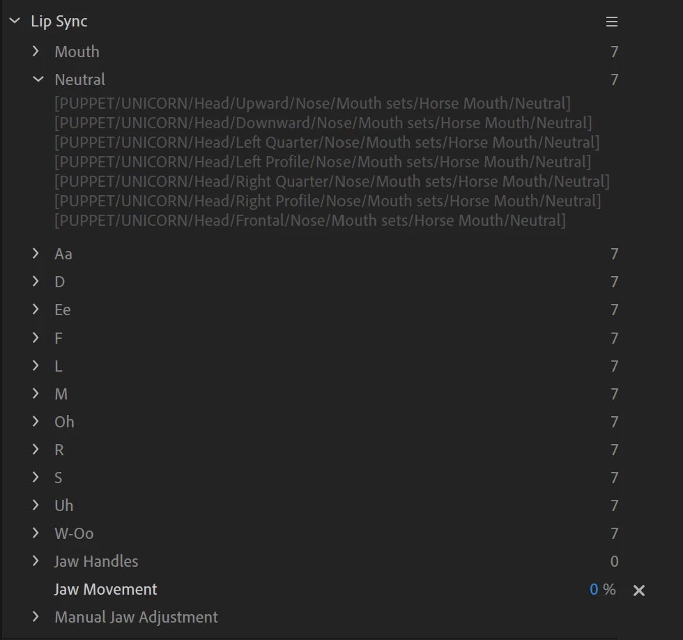

Oh, I found a puppet with multiple layers (7 in this case).
This might not be the problem - its just a good first step. Next is can you include a screenshot of the rigging hierarhcy. Please expand the alternate mouths hierarchy so can see that. Just wondering if a trigger issue instead, but that is a bit hard to see from the video you supplied.
