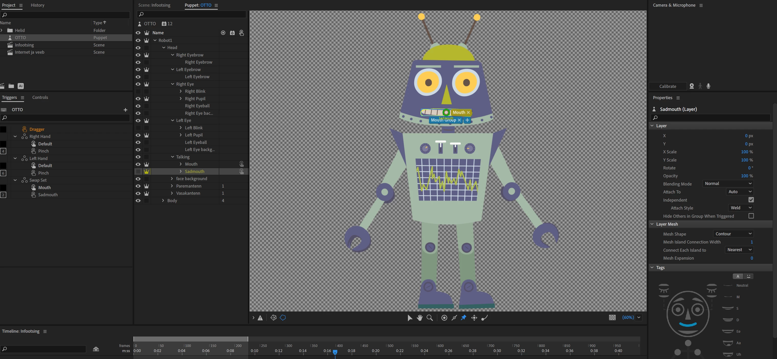

Hi!
I have a character with alternate sad mouth set and everything is working with changing the mouth set and with the lip sync.
Where I'm in trouble is using the Face recording to change the mouth size with "Mouth strength". The same thing actually happens for example with alterante eyebrows that don't move with Face recording (just tried it for testing purpose).
I have set the correct tag for alternate mouth, swap set and have looked at everything I could think of. Can you help me please?
I attached a screenshot of the puppet.

If you click on the little triangle with an (!) in it, does it tell you about any rigging issues?
mikko80397289
Jul 14, 2022 10:04 AM UTC
Not any issues that should prevent to alternate mouth to change size.
As I found out for example the demo puppet Chloe has the exact same issue that i described above.
