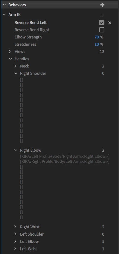

The left arm does not move as it should (from the angle it should move like the right arm).
I wanted to solve this with ARM IK so that it moves in the opposite direction.  Unfortunately ARM IK does not align anything.
I tagged all body parts as Okay Samurai explains in the video.
When I then look into the handles of the ARM IK behavior, some tags are not recognized.
It looks weird when i move from right to left.

But you said you want the left arm to angle like the right arm. So I opened up the properties panel. There are 13 views it has identified!! And it failed to find any right shoulders!! So clearly Arm IK is getting confused.

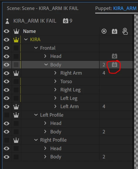

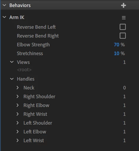

So I removed the behavior from the root of the puppet and added it to Kira/Frontal/Body
The views and handles looked more sane then.
