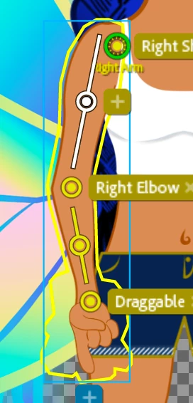

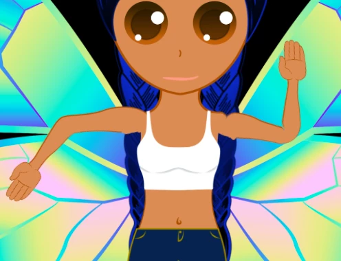

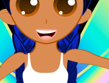

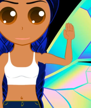

I added arm IK to my new puppet. Where the shoulder connects seemed a little weird to me, it bends at an awkward angle like this: it just looks weird to me. Like the shoulder shouldn't bend like that. I moved up the stick that kept the forearm straight and the dent got smaller, but still noticeable to me. Maybe it's too nitpick-y but I wanted to change so I switched the attach mode on the right arm group to Henge. It looks like this: it looks much more natural, despite the fact that I need to smooth things out on my art work, however Arm IK doesn't work any more. Or I should say auto-bend. It's still selected however the arms doesn't automatically switch the the other side. So I was wondering if there is a way to make arm IK work with Hinge mode? I unchecked auto-bend and tried using reverse bend left & reverse bend right, but neither of those worked either.

when I use hinge auto-bend doesn't work. it just rotates in a full circle. So I tried making a new arm and seeing if it was the arm shape that was giving me problems. but that wasn't it. so next I moved the shoulder tag and the stick tag so that they connected. that seemed to make it better however auto-bend stopped working for some reason. so finally I came to this having the stick next to the shoulder kept it from doing a weird bend.

Bottom line, if you can include screenshots of the rigging view with the arm and torso selected (if independent) it can help - showing the sticks, handle positions etc.
