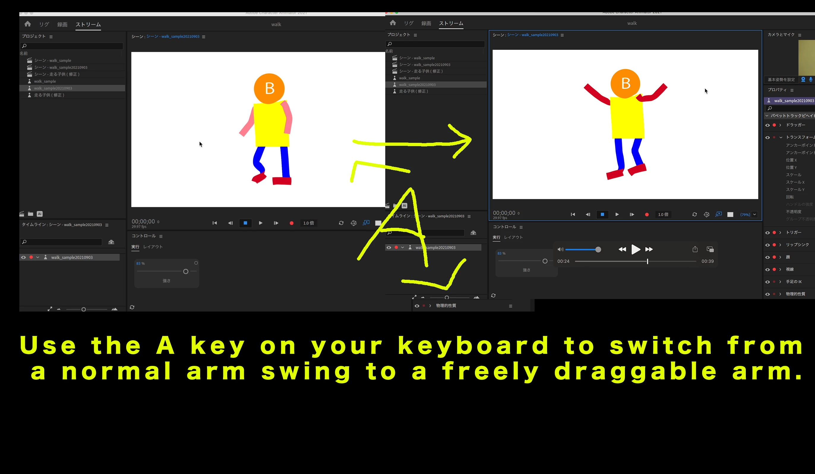

I improved my puppet a little.
Use the A key on your keyboard to switch from a normal arm swing to a freely draggable arm.
DropBox
https://www.dropbox.com/s/cwmu6o2wh9nsqdc/add_swap_walk_sample20210903.puppet?dl=0
YouTube
https://youtu.be/fCcMi8n8DRQ

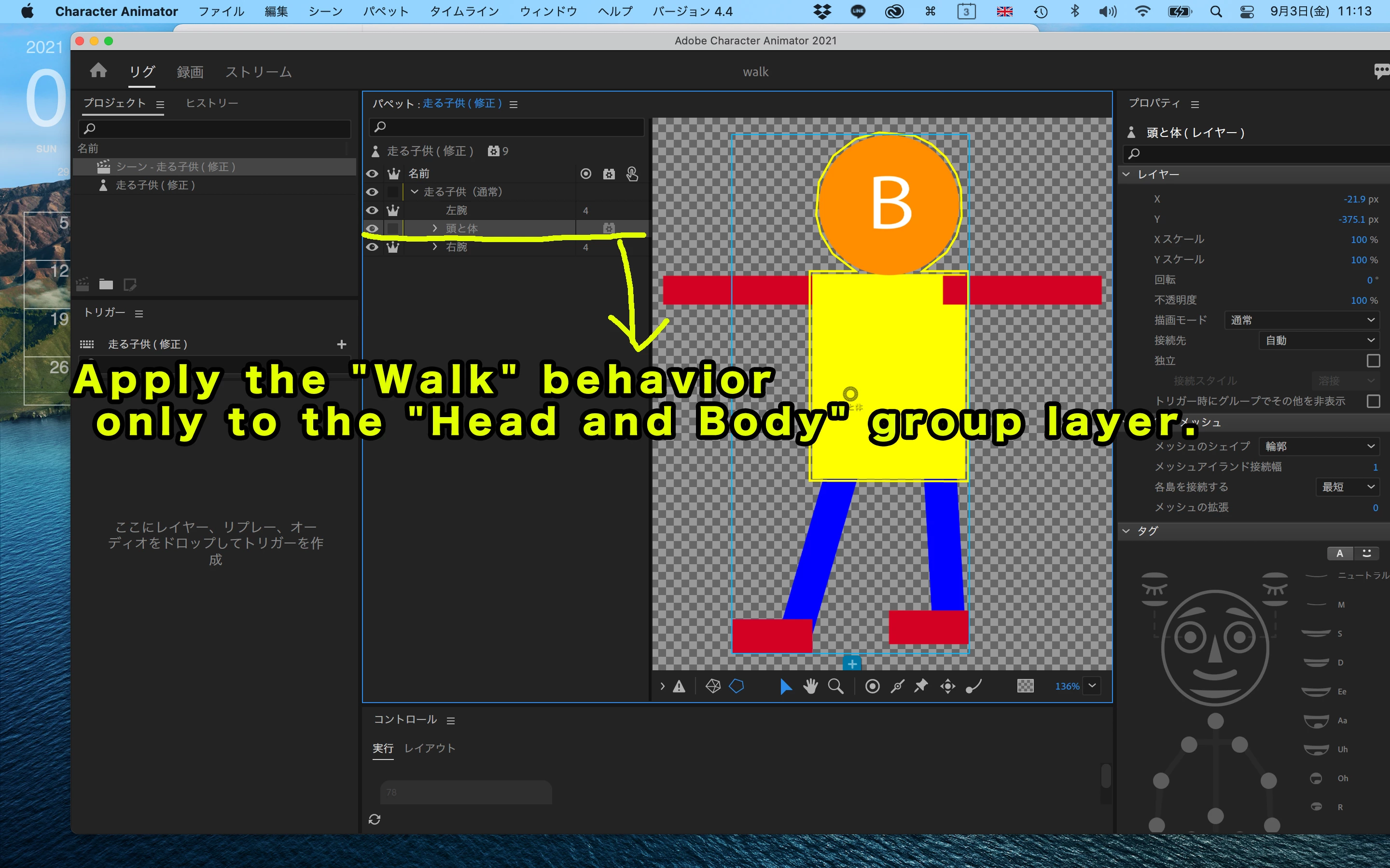

Sep 3, 2021 2:37 AM UTC
Translated Japanese into English using translation software.
1) Divide the layer structure into "Arms" and "Head and Body".
2) Tag the Arm layer with "Shoulder", "Elbow", and "Wrist", and add "limb IK" behaviors.
3) Apply the "Walk" behavior only to the "Head and Body" group layer.
A sample puppet has been uploaded to DropBox.
https://www.dropbox.com/s/2w6kfg87cd1tgg5/walk_sample20210903.puppet?dl=0
