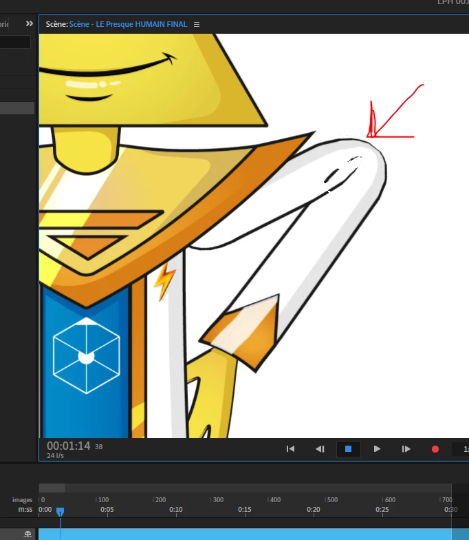

Hello, I need your help! I have a particular glitch on my arms that I can't get rid of, as soon as the forearm crosses the arm the contours get mixed up and it looks like this, I've tried everything but I can't figure out where the problem is. thank you in advance

Try grouping the upper arm artwork together in a named group, then group lower arm artwork in a named group. Then move lower arm group above upper arm so ch knows to display it in front. If necessary, chop the existing artwork in half near the elbow to get it right. You may need to experiment with the right place to chop it.
(Searching for "elbow" in the forums brings up some other similar threads with discussions too.)
