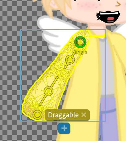

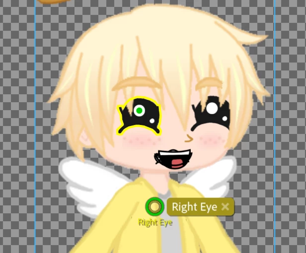

This has been a long drawn out process but I think I'm getting close to having my first working puppet. As the title states I'm only having three problems currently. Below will be a link to my puppet so that everyone can see the rigging and set up and tell me where my problems are and how to fix them. Thank you in advance.

With the arms overlapping the body so much, I think you will need the arms to be independent if you want the upper arm to move without dragging the body around. If you make the arms independent, then you will need to move the sticks and draggers to the arm layers for them to work.
The right eye is going funny because the origin has been moved from the middle of the eye down to over the chest. So if the chest moves, the eye will move. Drag the origin back to the center of the eye and it should behalf like the left eye again.

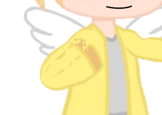

After fixing them, there is another problem if you want to fix it. When the arm folds back over the arm, it goes a bit funny.
You can fix this problem by chopping the arm artwork in half, then group the artwork into the upper arm and lower arm, then move the upper arm group above the lower arm group. Don't make the upper or lower group independent (just leave the arm independent). What it does is tells CH when the artwork overlaps, which should be in front.

Thank you so much all that was a real help. I now have two small issues though. 1. The arms are now really loose. I have to strech them way out to get them to bend at the elbow and wave. 2. I had to make the wings there own layer inside the body group so that his left arm would not endup behind the wing but is still behind his body when resting. It has detached his head and arms from his body. It really funny looking.
