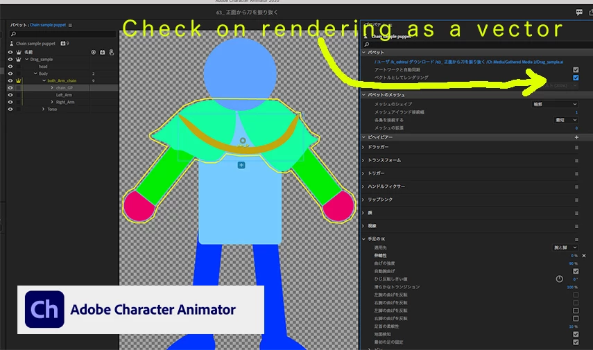

k_oshiro
December 9, 2020
Translated from Japanese to English with translation software.
Currently, "Continuous Rasterization" in Adobe After Effects is not compatible with Adobe CharacterAnimator.
So Adobe After Effects does not have the ability to do "continuous rasterization" like Adobe Illustrator files.
So, when you zoom in, it will be blurry.
If you want to zoom in, you'll have to zoom in on the Adobe CharacterAnimator side.
If you want to enlarge the image, you need to check "Render as Vector" in Adobe CharacterAnimator.
I hope my suggestions will help you.
k_oshiro(AdobeCommunityExpert)
