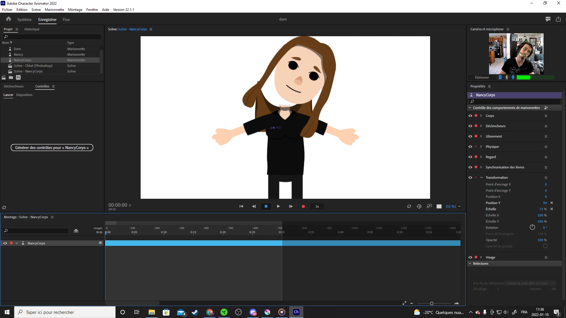

body not detected i think
its my first time making a character so i used chloe's base but it seems like one i import in back into character animator it doesnt detect the body and i've put the behaviour body so i dont see much that can help me at this point

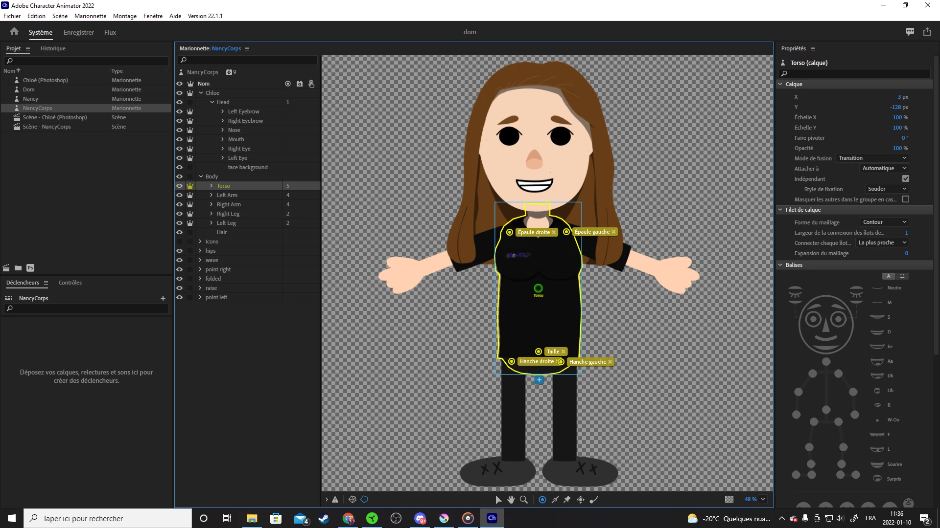

Everything should be inside a single root layer (the character name). Your Body is not inside "Chloe", so is considered a separate puppet. I would give that a go to see how it works.

Thanks it worked, cant believe it was so simple tho xD
