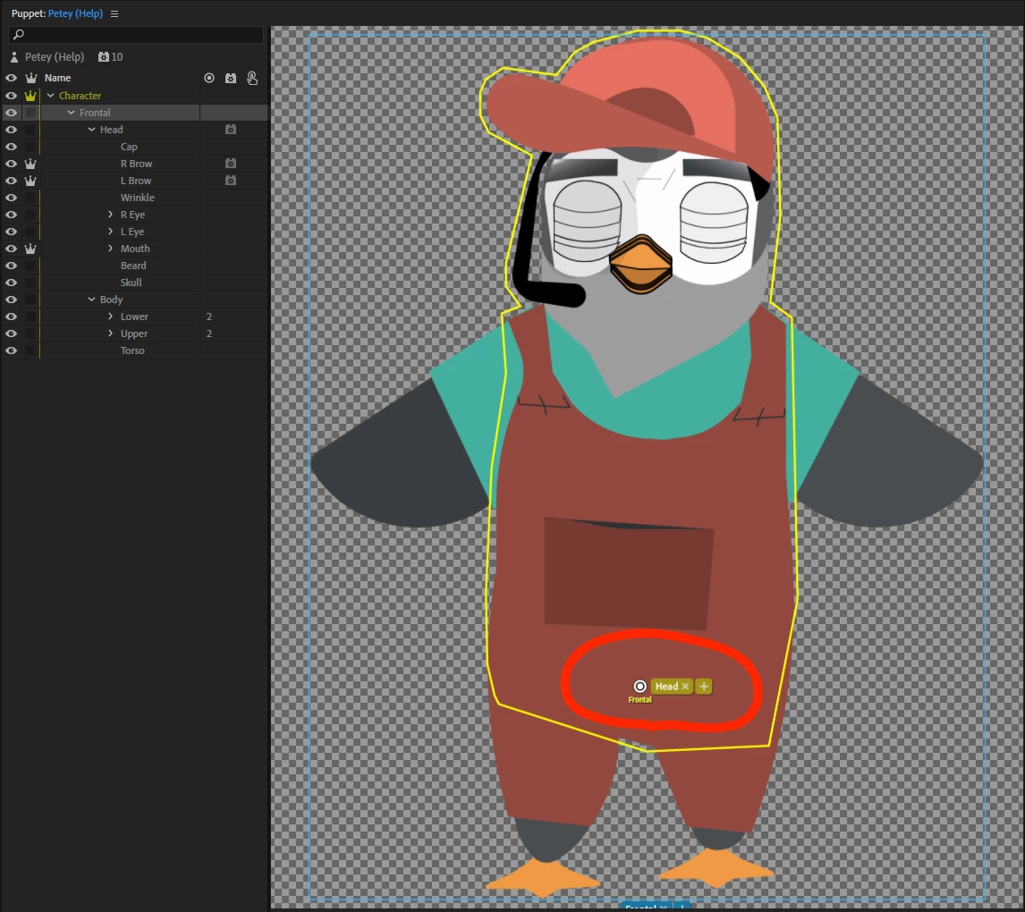

It is because the arm retargeting is based on where the head is. The puppet's head is at its waist. The body tags need to be at anatomically-correct locations. Otherwise, the retargeting will not work.
Aug 1, 2023 1:19 PM UTC
Oh okay. Let me try that one
Thanks!
