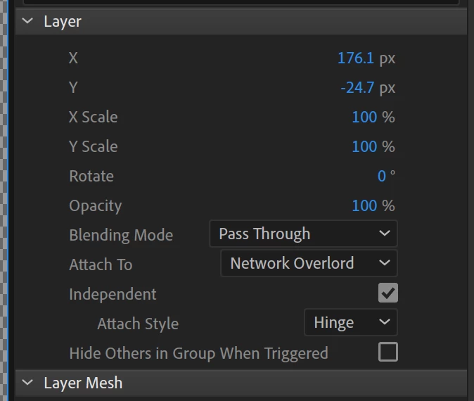

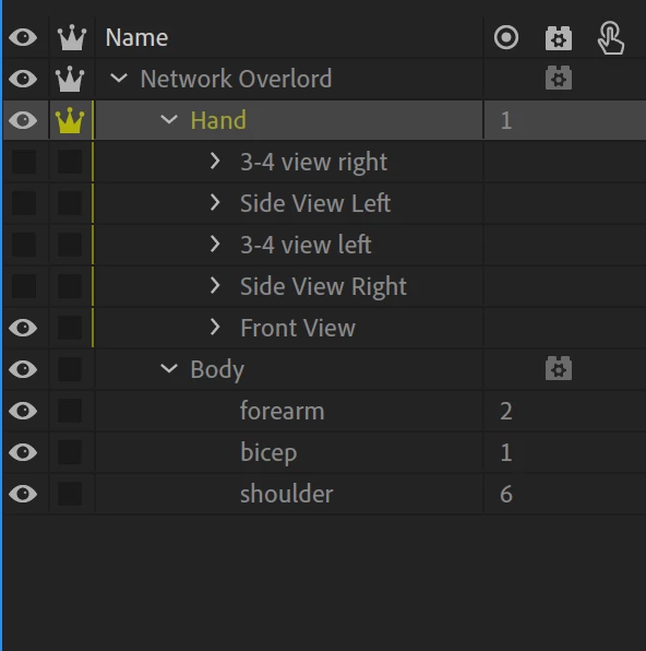

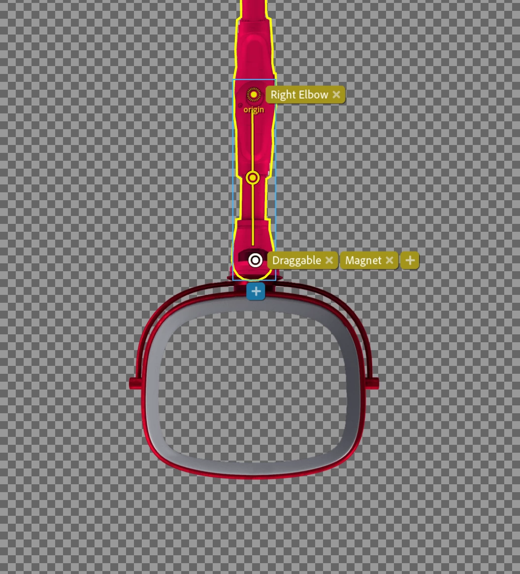

Sorry for the late reply. I was away for the holidays. So I tried hinge. And it did what I wanted. BUT, now the monitor isn't attaching right. I even tried putting a magnet on the end of the monitor and the end of the hand, but it didn't help. Here's some images. Let me know if you can see what I'm doing wrong.

I always set "attach to" type as "Auto" (never a layer name) - I never got anything other than "Auto" to work. (Your screenshot shows "Network Overlord".) You then drag the origin of the Head (err, Hand?) over the body artwork (yellow highlighted region) so the body turns pale green (indicating correct attachment). Children attach to parents (not the other way around).
(I would not bother with magnets unless needed. Sounded like Hinge was working - I would proceed with that.)
