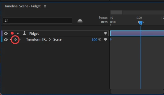

TheOriginalGC
Apr 12, 2024 7:00 PM UTC
You should be able add new keyframes to the timeline by clicking on the diamond shape as shown below. Just move the timeline bar to the place you want to put the key frame and then click on the button.
