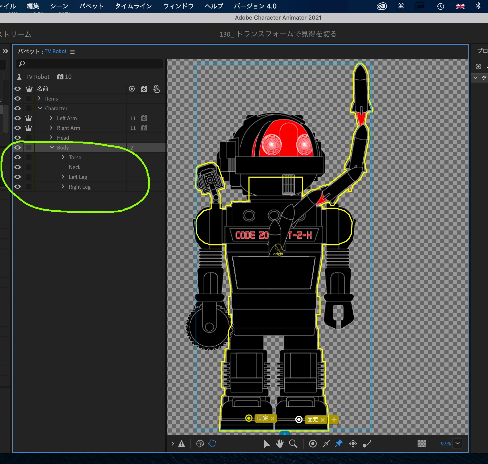

I have fixed the movement of the body.
1) Regarding body movements, I uploaded a modified puppet to Dropbox.
2) Removed the crown mark from the head layer.
3) Create a new Body layer and add a Torso layer and a foot layer did.
4) I pinned the foot part of the Body layer.
https://www.dropbox.com/s/nb6z3jm43402y73/edti_TV%20Robot.puppet?dl=0
Thank you.
