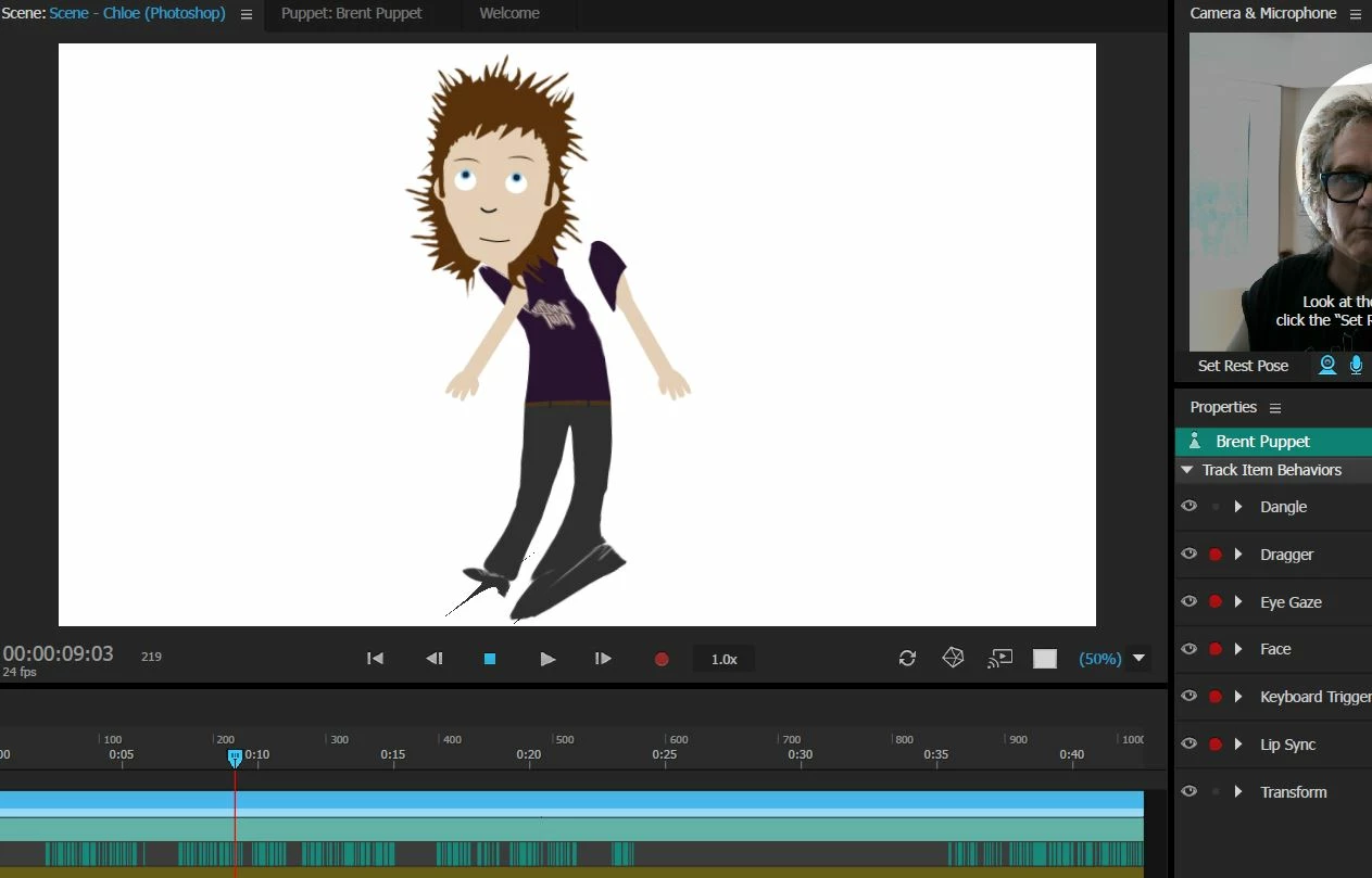

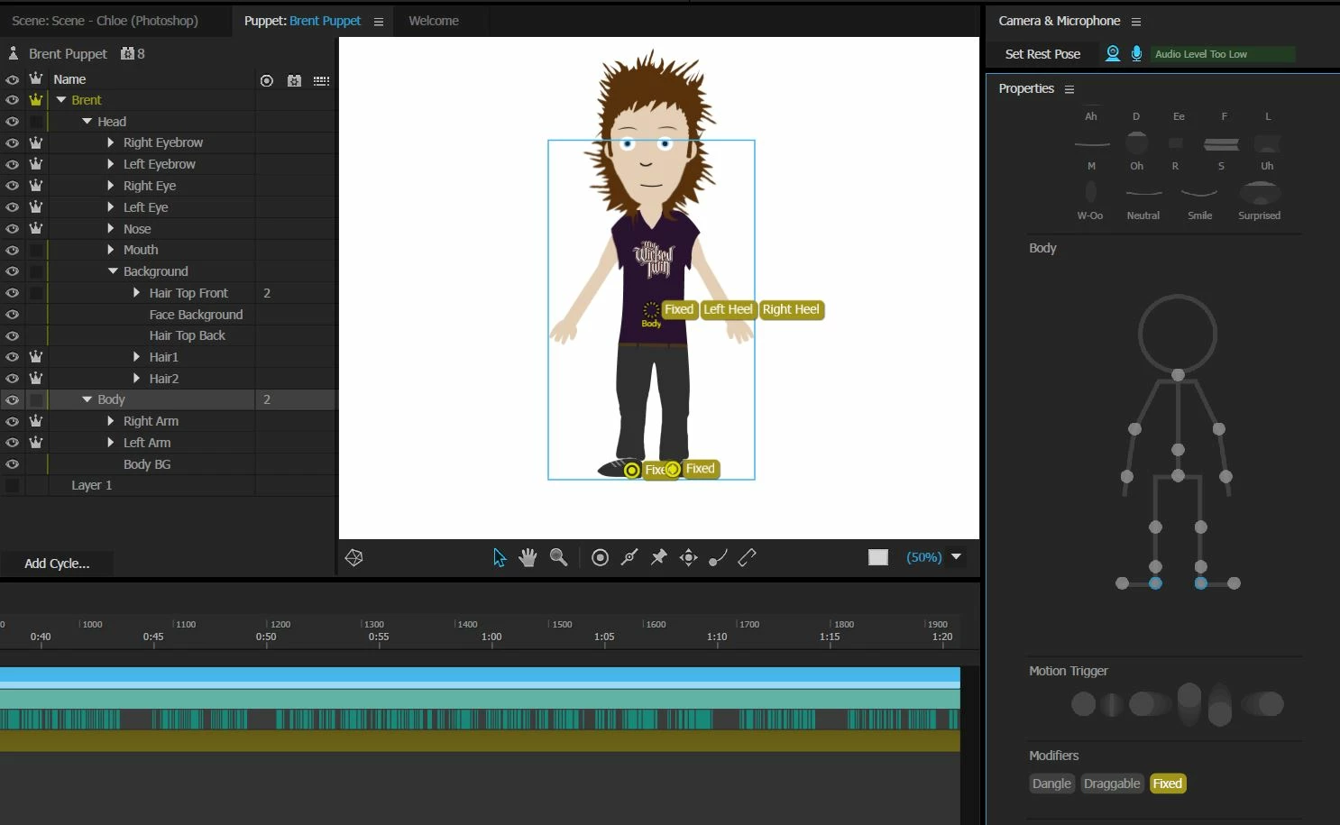

Again, unable to fix feet to floor:
Inventsable
Oct 5, 2017 6:13 PM UTC
It looks correct from here with exception to the body anchor being tagged as Left Heel and Right Heel. Also, what is "Layer 1" in this puppet? This Layer 1 may be changing the size of the distortion mesh and causing those bad morphs even if it isn't set to visible.
I notice that you haven't used the Staple tool to attach your right and left arms to the body, but otherwise I can't tell what's going wrong. Can you highlight your puppet in the Project panel, and do File > Export > Puppet, then upload that file for me here so I can take a look inside for myself and try to diagnose the problem?

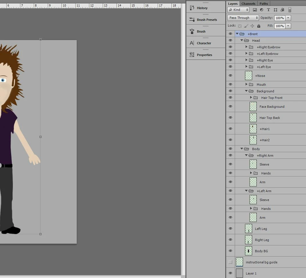

Red Brent
Oct 5, 2017 10:25 PM UTC
By unchecking the 'crown' icon, I've managed to make things work, but not before following your advice and adding staples to body parts. Thanks so much for your direction ! Here is a pic of my Photo Shop hierarchy
