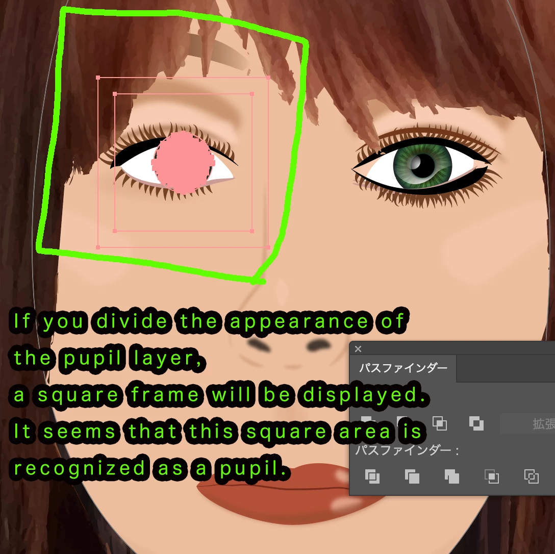

I found out why the puppet's eyes didn't move.
However, it is difficult to explain in English.
I uploaded the sample puppet to Dropbox again.
https://www.dropbox.com/s/gz9aonra6a79549/fix_eye_edit_Abbe%20Puppet.puppet?dl=0
The pupil seems to be too wide.
If you try to divide the appearance of the pupil layer, a square frame will be displayed.
It seems that this square area is recognized as a pupil.
By deleting this square frame, the pupil moved up, down, left and right.

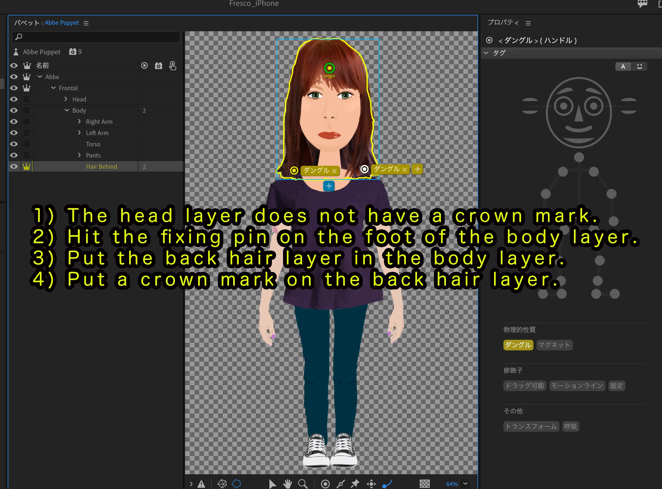

1) The head layer does not have a crown mark.
2) Hit the fixing pin on the foot of the body layer.
3) Put the back hair layer in the body layer.
4) Put a crown mark on the back hair layer.
I uploaded the modified puppet to Dropbox.
https://www.dropbox.com/s/xznm6du5oa2n4v0/edit2_Abbe%20Puppet.puppet?dl=0
Although it is in Japanese, the commentary video has been uploaded.
https://youtu.be/VXQbxgOks0Q
Sorry.
