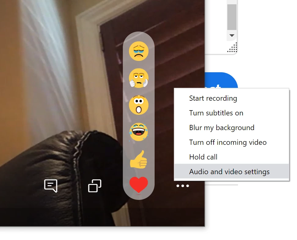

Here is the bottom right corner of my skype window.

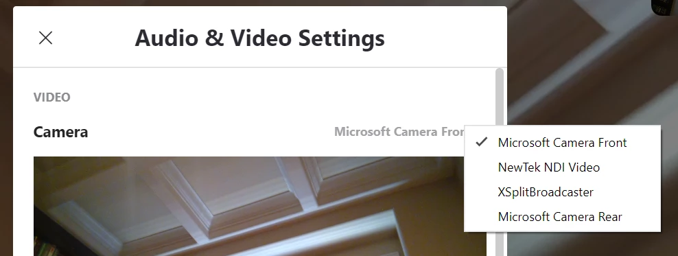

If I pick NewTek NDI Video, I get a black screen because NDI Virtual Input is not running. When I start it up, the window is still black but you get the little icon in the system tray (might need to click the white up arrow next to it).

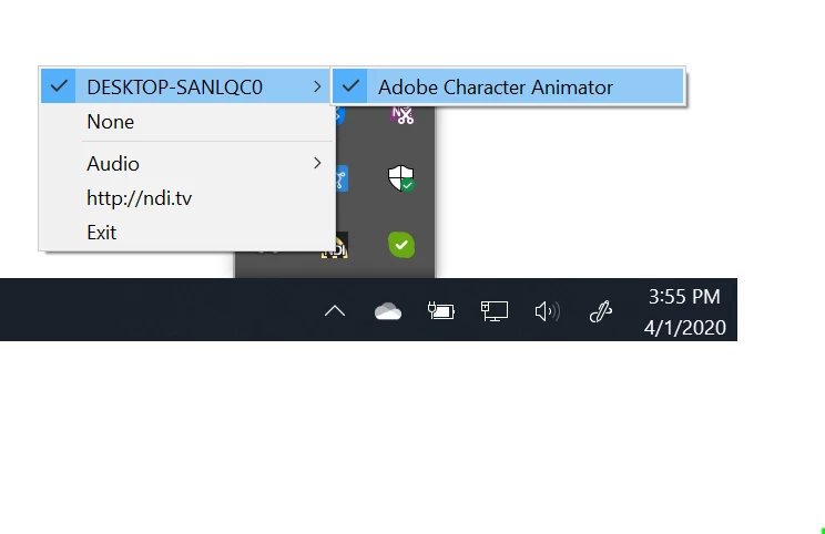

Right click on the icon to set the NDI input stream to read from...

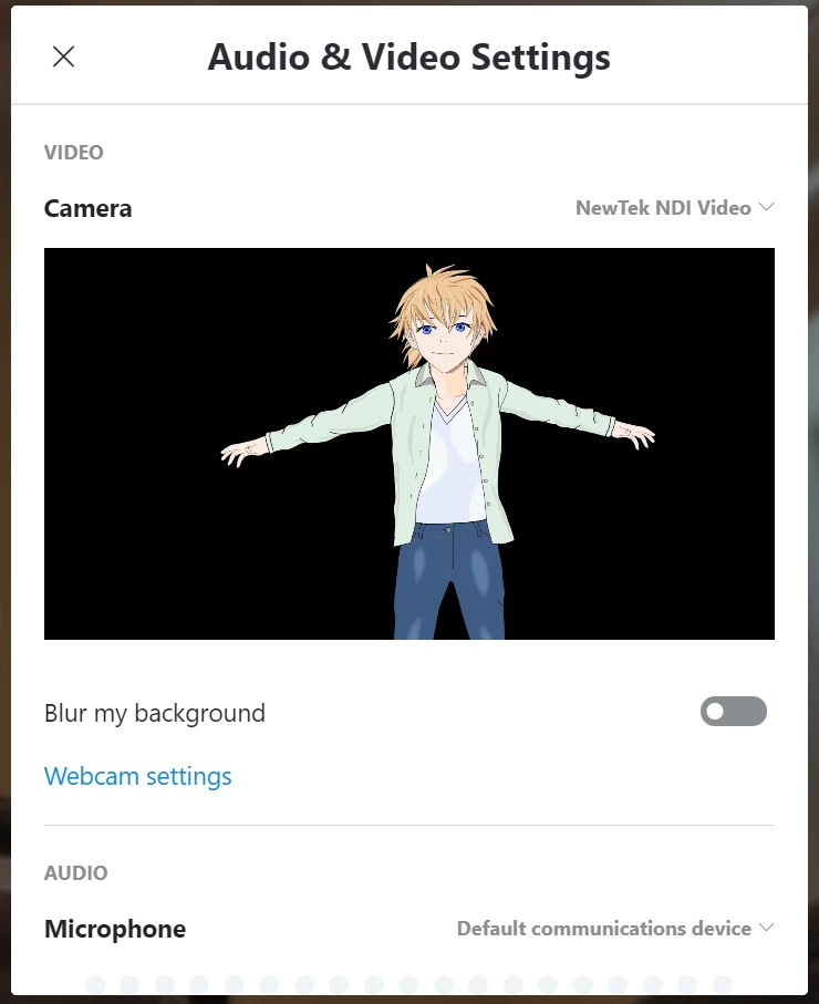

Wait for like 15 seconds to be sure. I am hoping it is this last step that you are missing.
I am hoping the other apps are defaulting to the virtual input as the default camera, but if you don't set the source to an app on your machine, then it will be black. But it works on my call. However it has like a 1 second lag, so might need to do magic for lipsync to look good.
