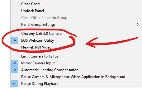

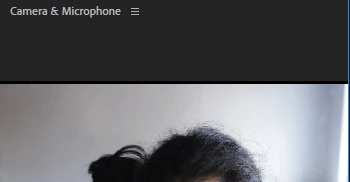

Although this is still a problem I just use the version of Character Animator that recognises all camera devices connected to my computer. It's a bug in the program that is only in a few versions, as it was never an issue before.
This screen shot is from the PC I'm using but this issue was in Mac. Screen shots are of menu to choose availible cam and the cams that are recognised by Char Anim.
