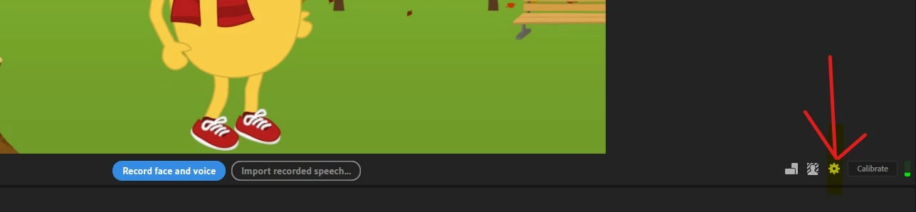

Just installed the app. I am signed into my account. In Starter Mode. ALL dropdown Menus are greyed (screen shot of one for reference). Camera works in other apps. No other apps using cam or mic currently.  Restarted computer,  switched USB ports for cam and mic (even though they work fine in other apps), etc.

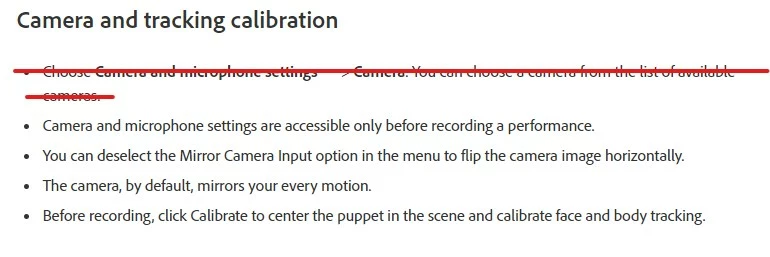

Update:
I think the Adobe instructions are wrong. I went ahead and grabbed a puppet. I was able to record video and audio. Cam and mic came on automatically when I started recording. Controls are STILL greyed out in Menu bar but at least I can play with it. Suggested edit to https://helpx.adobe.com/adobe-character-animator/using/starter-mode.html  attached (this was my experience, anyway.)
"Camera and tracking calibration" (ADD "via the gear icon in bottom right corner")
