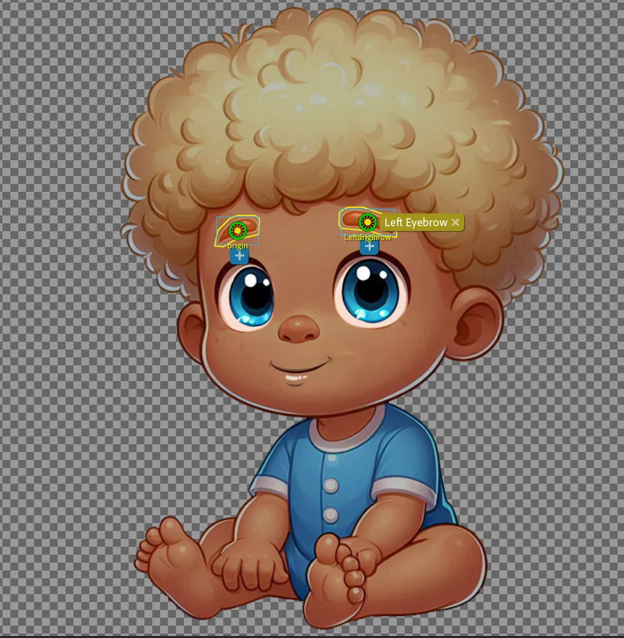

When I add a trigger to my eyebrows, they disappear in the record tab.
Then if I press the trigger (e) the eye brows appear while I'm pressing the utoon.
I want them to move up and down... What am I doing wrong?

As far as the attached image is concerned
It appears that the right eyebrow is not tagged with the right brow.
Try selecting the right eyebrow from the doll icon on the right and add a tag.

OK, I did that... But the eyebrows still disappear once I add a trigger and go into record mode.
The eyebrows work great, when linked to the camera, but disappear when I add a trigger.
Maybe I'm adding the trigger wrong, but my other triggers work for laughing and blinking...

Sorry about that, OK. Done!
Thanks for sharing your puppet with us.
I was able to download it.
The puppet you sent me does not disappear, especially the eyebrows. It works fine.
It is a fine puppet, but I made a few modifications on my end to make it better.
1) I separated the head and body layers so that the feet can be fixed to the ground.
2) The smile changes by pressing the keyboard keys “1”, “2” and “3”. The smile also moves with the face.
For your reference.
https://drive.google.com/file/d/1T0o7Y2kBDXu1Uvwf8RtlbO28Pm94jw4Z/view?usp=sharing
