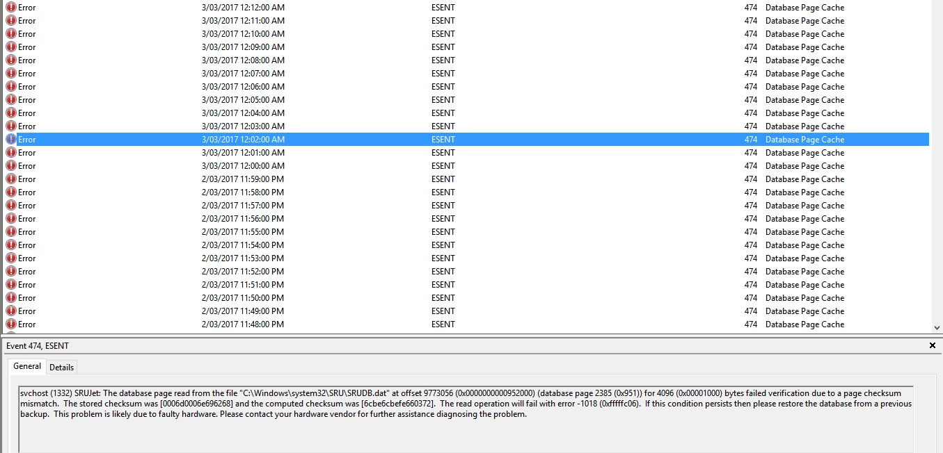

    So chances are, my issue is unique to me, but it would be great to figure out why Adobe sets it off. Here is the error that clutters my error log viewer. Hopefully it's relevant..

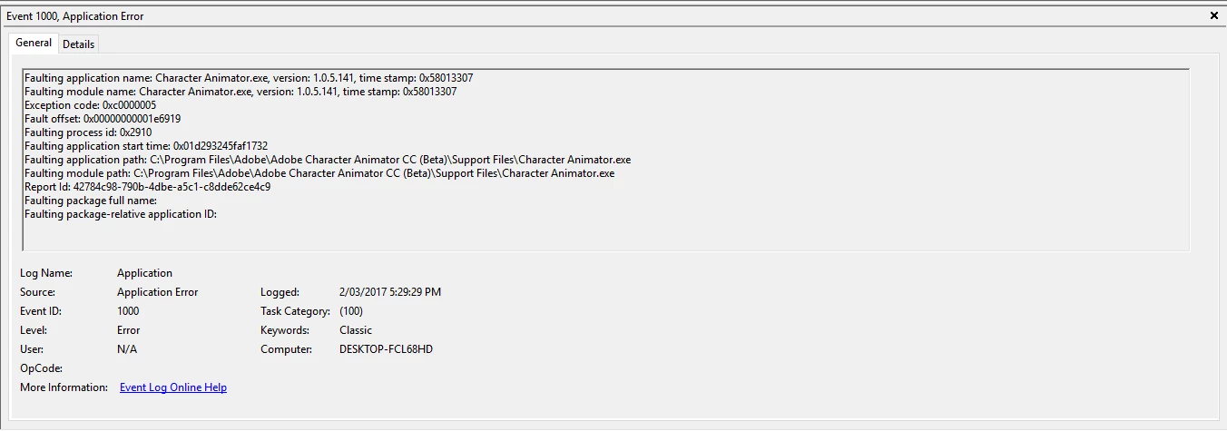

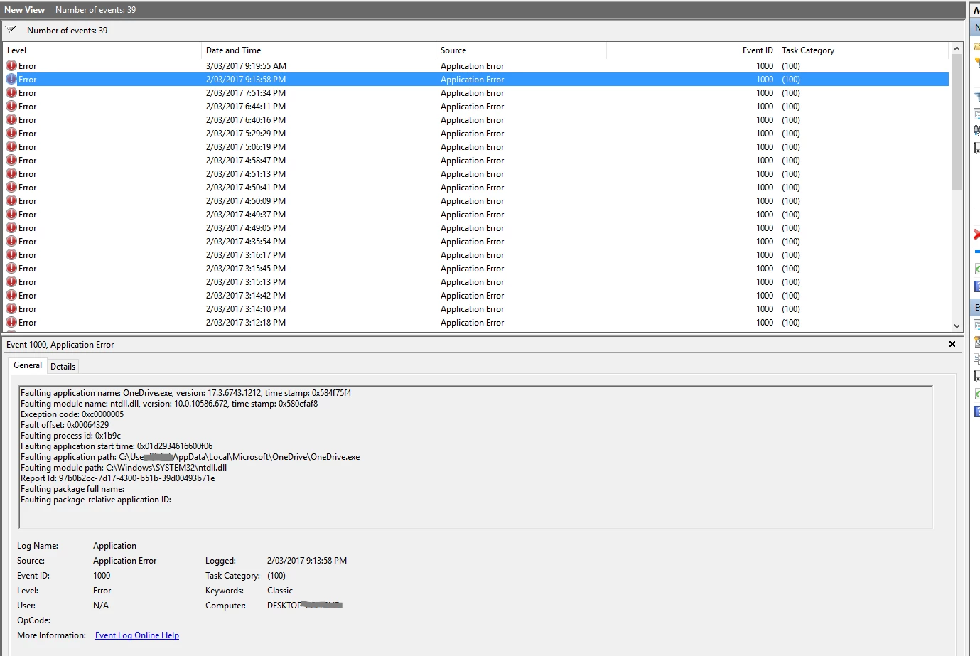

    Okay, so over the past 24 hours, filtering for Application Errors / Crashes, I see a lot of OneDrive Errors, reportedly crashing 38 times in that time. Strangely enough i only have one Application Error from Character Animator.  I've attached the imagery below. Also i don't explicit access any files using OneDrive, it must be having it's own 'fun' in the background.

    Yikes, those Database Page Cache errors sound bad. Checksums failing in database pages suggest some kind of serious bug or (disk) hardware failure (as noted in the detailed part of that message). Googling around for ESENT, SRUDB.dat, and some of the phrasing in that message turns up a lot of different threads discussing such issues and it sounds like you probably want to make sure all of your stuff on your disk is backed up (ideally separately from backups that precede these errors in case other files that do not use checksums extensively have also been silently corrupted).
    I'd have to do some further research to understand, but it definitely sounds like a problem you'll want to try to get sorted out. I do see some threads mentioning this error correlating with system responsiveness issues.
    One reason Ch might be particularly sensitive is that our project format uses checksums for all the  pieces of data it writes, so it is quick to notice corrupt data by virtue of the data not matching the checksum it expected. Which is to say that we may be more of a canary in a coal mine that a causal factor here. It's also possible that writing lots of small files as our project contains  makes whatever hardware or lower level software issue is going on here.

    Just as a start, if you can run Event Viewer (it should come up if you use the search box in the task bar). In the left hand panel, expand Windows Logs and choose Application under that.
    Since this happened recently, there should be an item toward the top of the list with a red exclamation icon and the text Application Hang or Application Error. If you can find one of those whose details reference Character Animator and paste the results from choosing the option to copy the event details as text from the right click menu, it may provide some clues I can use to home in on the kind of failure that occurred and what might have caused it.
