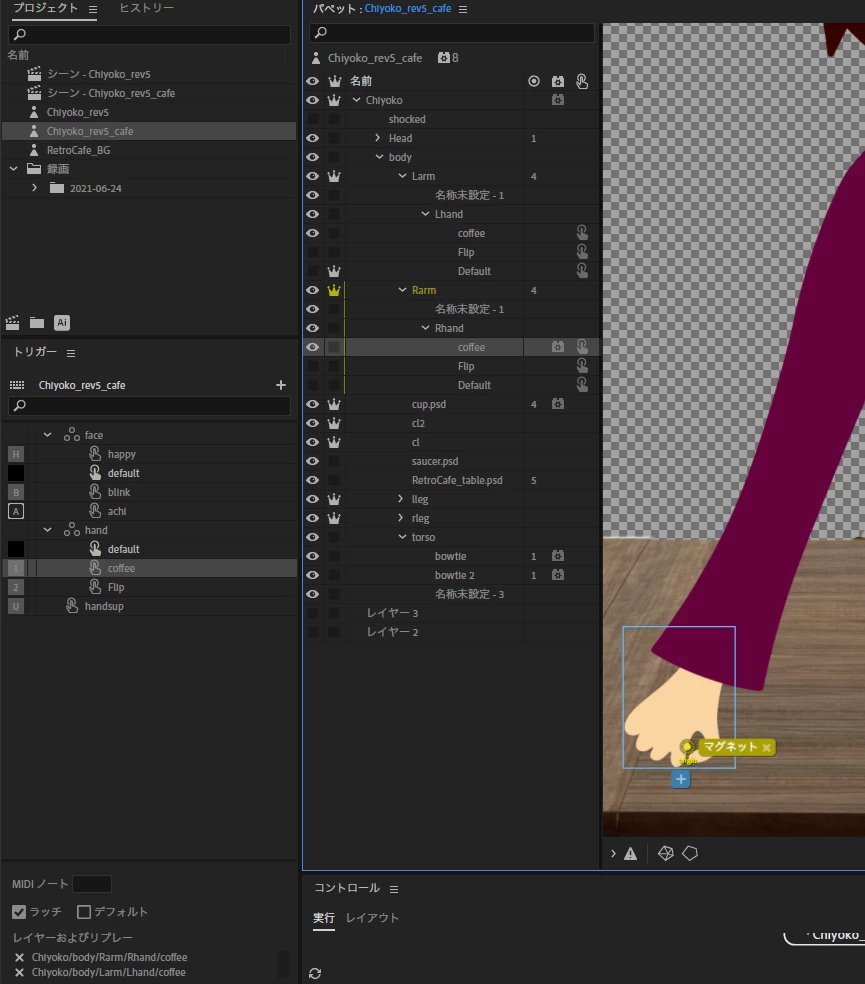

[Character Animator] I can't let go of coffee cup
I'm trying to make an animation of drinking coffee with the magnet function, but the cup follows me even if I turn off the magnet function with the trigger function.
I'm trying to do the same thing as the fish in Okey Samurai's video, but I don't know why it doesn't work.

Jun 25, 2021 10:06 AM UTC
I translated Japanese into English using a translation software.
Perhaps when you let go of the coffee cup, the wrist layer is not switching to the OFF layer of the magnet.
I made a tutorial on magnet behaviors a while back.
It shows how to hold and drop a gun by switching between ON and OFF.
It's in Japanese, but I'm sure you can speak Japanese, so please refer to it.
https://youtu.be/xIqhMITF6_E?t=303
If you can't get it to work, export your puppet file and share it with me on Dropbox or Googledrive.
I can give you more advice.
Thank you.

k_oshiroCommunity ExpertCorrect answer
Thank you.
k_oshiro(AdobeCommunityExpert)
ostwaldAuthor
Jun 25, 2021 10:42 AM UTC
Thanks i got figure this out!ありがとうございます!!
