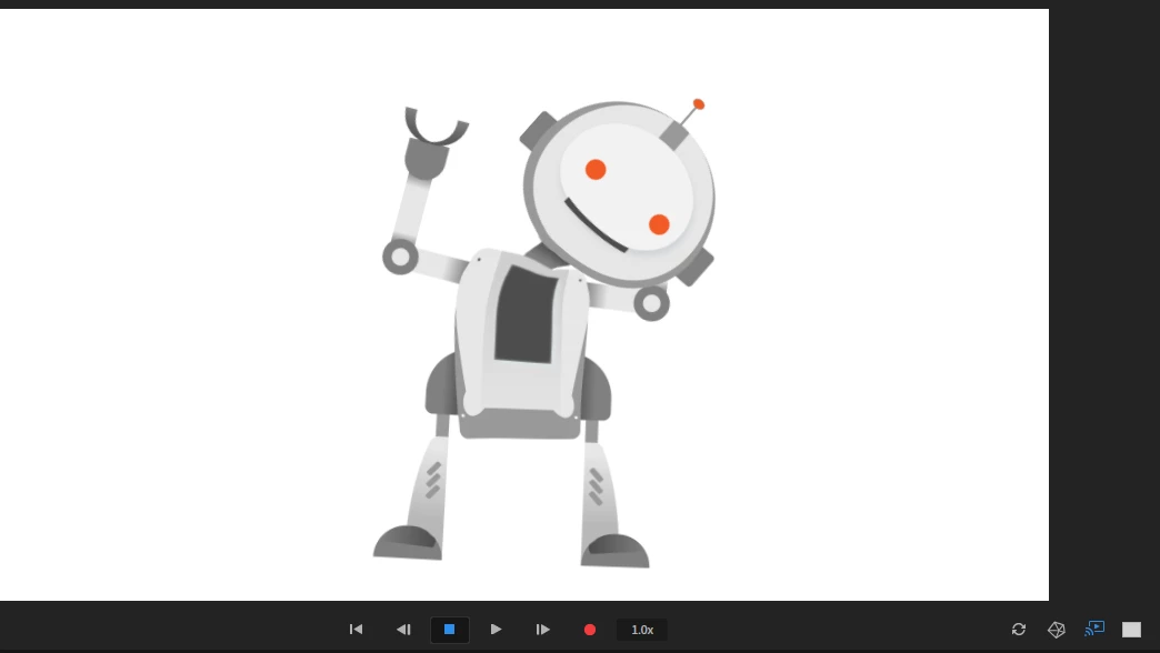

Hi, I really hope someone can help me with this. The last couple of puppets I made have always looked a bit bent and squished together and I don't know why. Below are pictures.

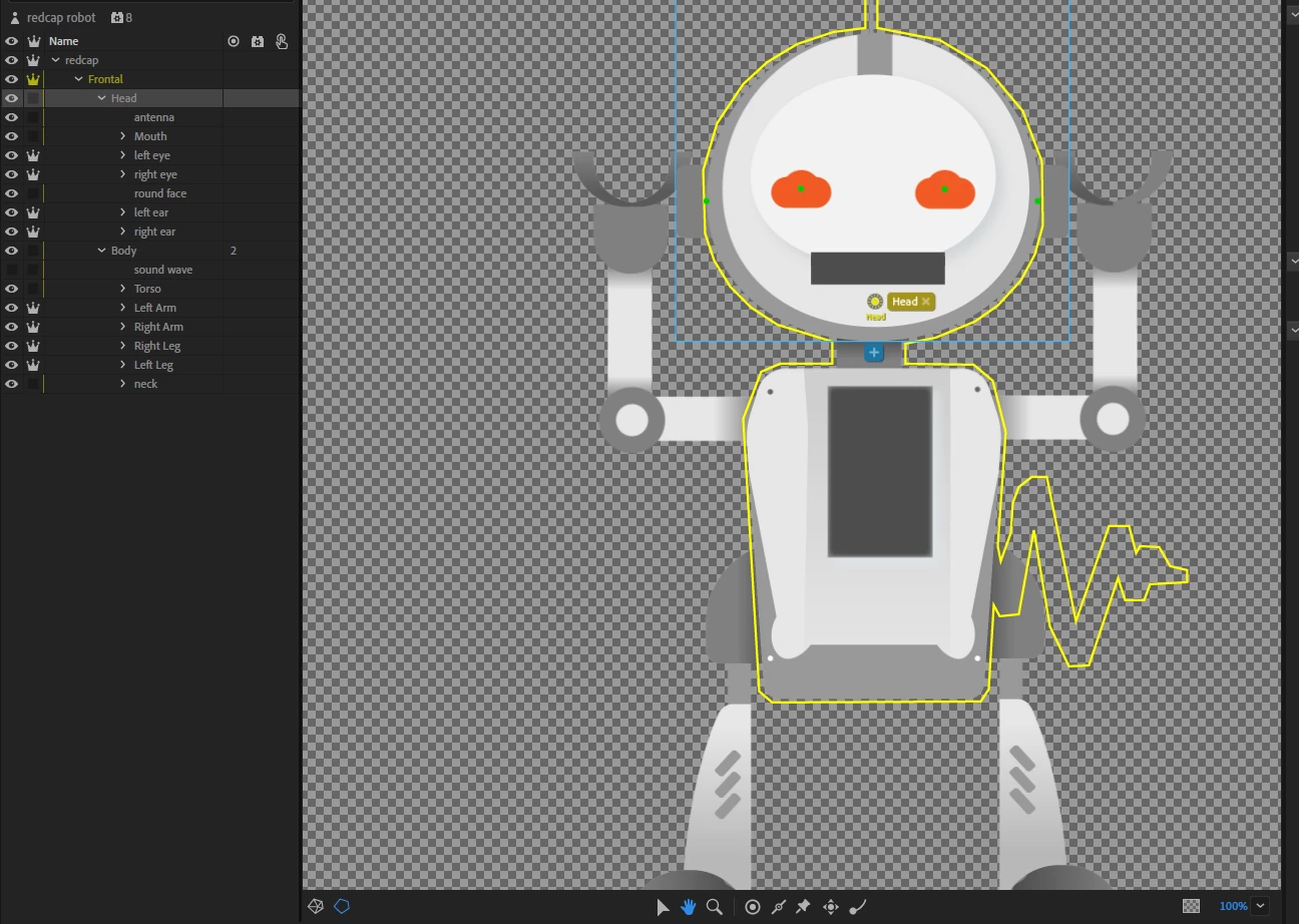

Make sure your "Frontal" group is set to "Free" as the Attachment Style. It may be set to "Weld" which is great if that layer is a character's nose, but since your entire character is under "Frontal", you want it set to "Free".

August 15, 2019
