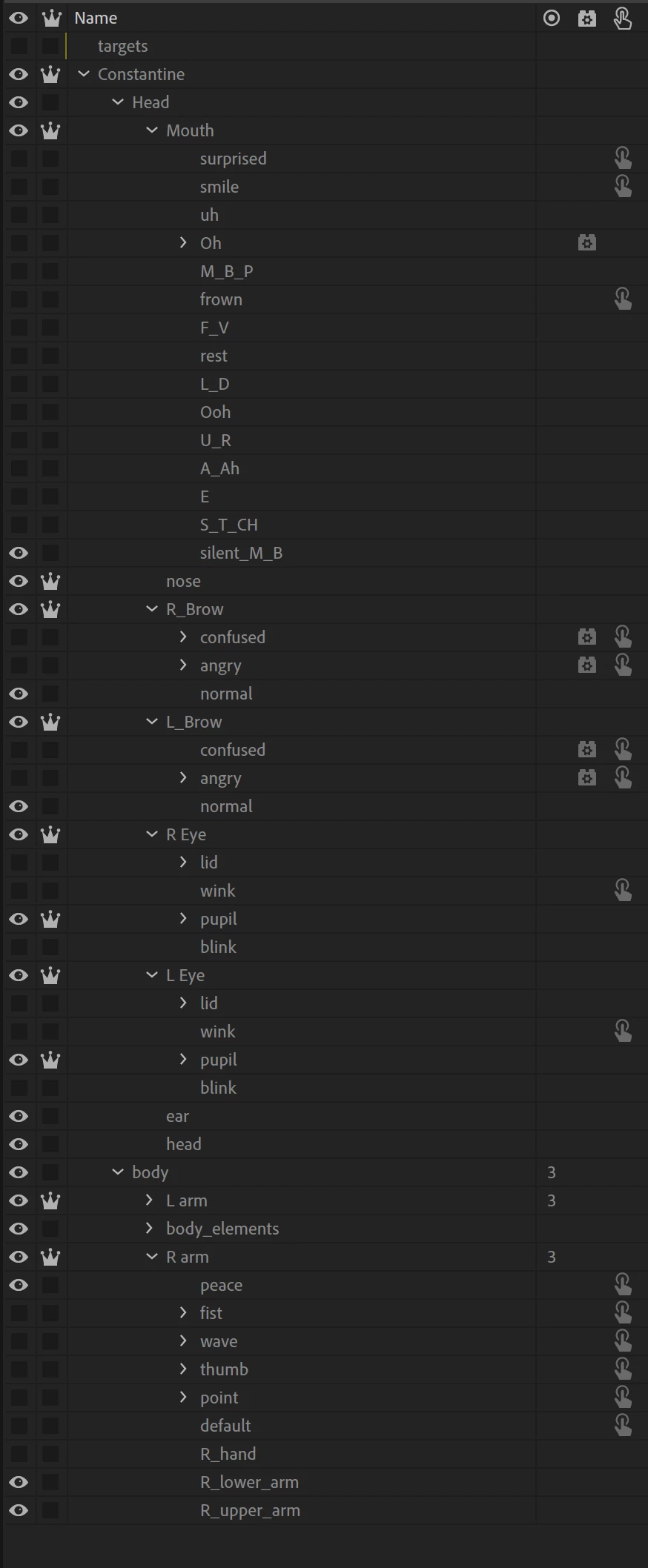

Can you share a screenshot of the rigging hierarchy? It is a bit hard to make suggestions without understanding the puppet structure. E.g. is the head independent? If so the head cannot move the body. Do you have sticks on the puppet? Pins? Share a bit more about the puppet structure and some folks might be able to make some suggestions.

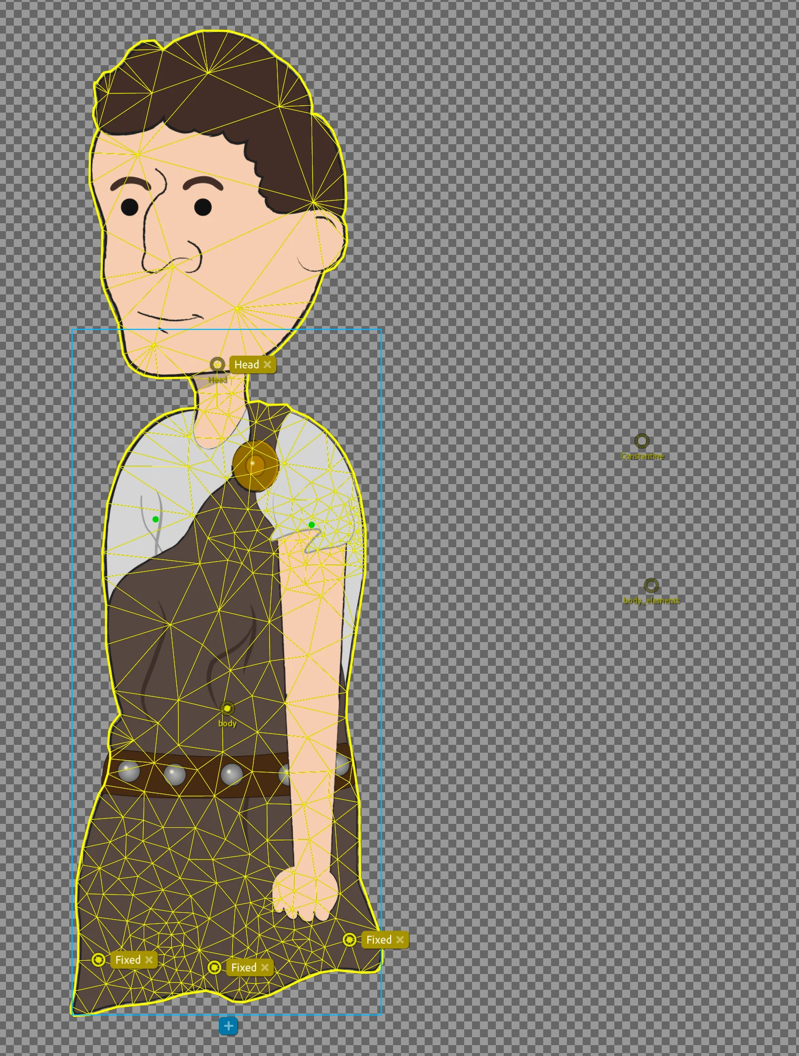

Thanks for getting back to me! I have attached a csreenshot of the rigging hierarchy and also the character with the mesh. Also he is pinned only from the bottom of his garb, by 3 pins.
The head and the body are separate sub groups under a main character group. I appreciate any help!

Nothing looks particularly wrong. Minor suggestions:
  • You have layers like "blink" and "R Eye". Just be away that autotagging looks lor layers like "Left Blink" and "Right Eye".
  • Try moving the "Head" handle higher on the head. I generally aim for about the middle of the head. Head movement pivots on this point.
