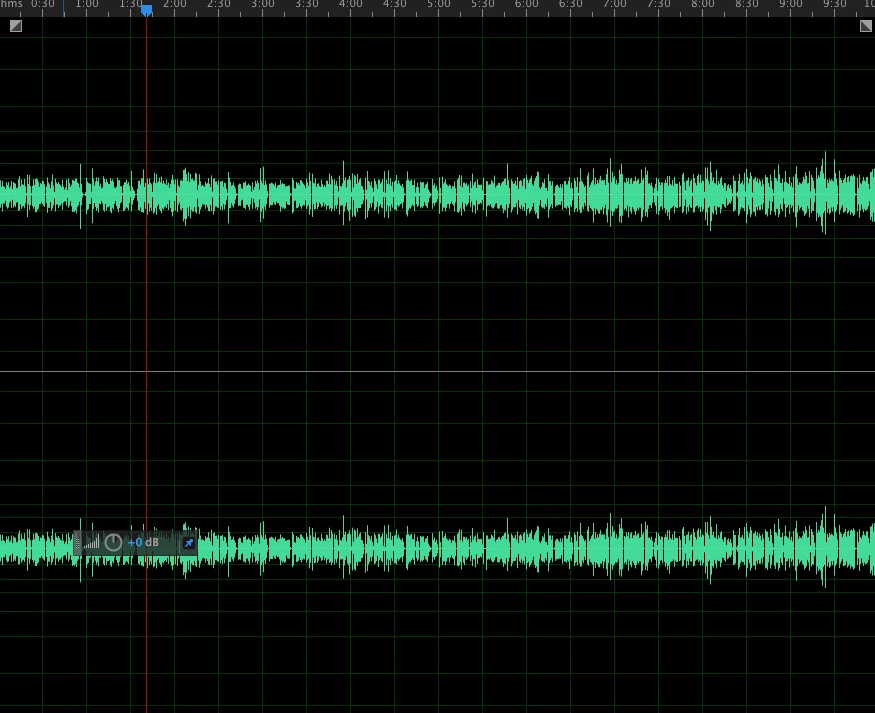

    So I bet the biggest culprit here is how low the audio volume is - if you open it up in Audition, for example, you can see how quiet the audio is. This means CH has to strain and do a lot more work trying to isolate the sounds. If you normalized or added a hard limiter to this, you should get much more reliable results.
    Overall it looks good - the biggest thing I see are some missing visemes every once in a while, which I think the higher volume should fix.
