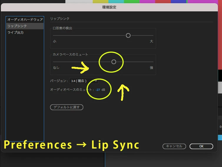

Probably because the sensitivity of the audio is too strong and it is picking up environmental sounds.
Go to Settings -> Lip Sync.
Increase the value of the audio base mute.
The default is -36dB, but in my case I have it set to -27dB.
I also increase the value of the camera base mute a bit.
Try the settings that suit you best.
