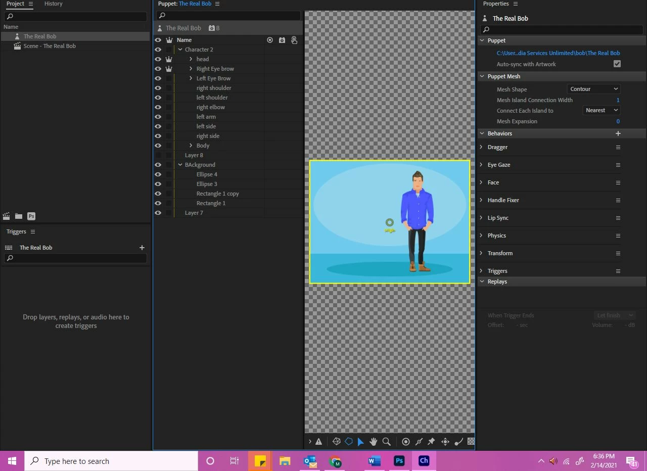

Hi, I'm using Character Animate for the first time.  Can someone help me understand why the head isn't moving when I have it on scene?  The webcam and microphone works.

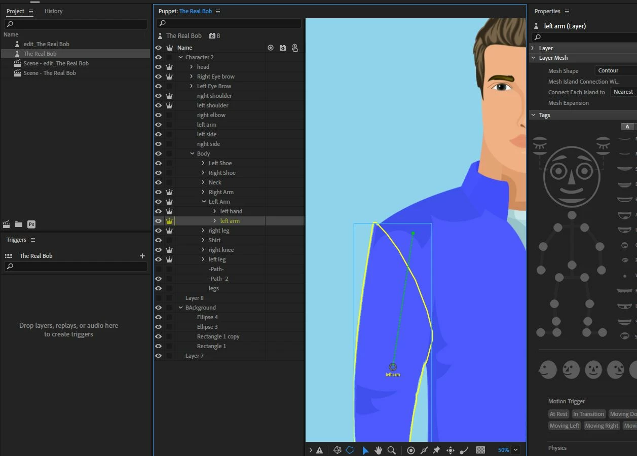

As far as I can see the screenshot you attached
The structure doesn't seem to be a problem.
Is this screenshot a puppet that I (k_oshiro) modified?
Or is it the puppet you modified?
I downloaded the puppet that I modified.
I then checked to see if the arms moved.
See the video.
https://youtu.be/eV8Vof5aoMg
The arms are working fine.
If the arms don't work on your puppet, please make it the same structure as my modified puppet.
If it still doesn't work, there may be another reason.
Thanks.

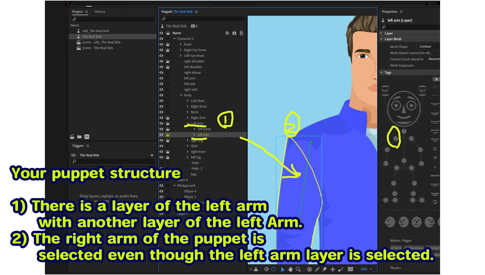

k_oshiro
Feb 16, 2021 1:36 PM UTC
Compare the layer structure of the doll you made and the doll modified by k_oshiro.
Layer structure of k_oshiro
1) The layer of the right arm is simple.
2) The right arm of the puppet is selected.
3) The human illustration on the right side is tagged with each part of the arm.
Your puppet structure
1) There is a layer of the left arm with another layer of the left Arm.
2) The right arm of the puppet is selected even though the left arm layer is selected.
There are many tutorials on YouTube about arms, and I think watching them is a good way to learn.
Thank you.
k_oshiro(AdobeCommunityExpert)
Feb 16, 2021 8:38 PM UTC
I reloaded the puppet that k_oshiro did, but the arm still doesn't move in scene mode.
Feb 17, 2021 7:44 PM UTC
OH!  I get it now!  I didn't know arm hand movements aren't controlled by the camera.  I'm so sorry!  Like I said I haven't had that much experience with Character Animor but that video cleared it up.  Thank you!  Thank you!  Thank you!

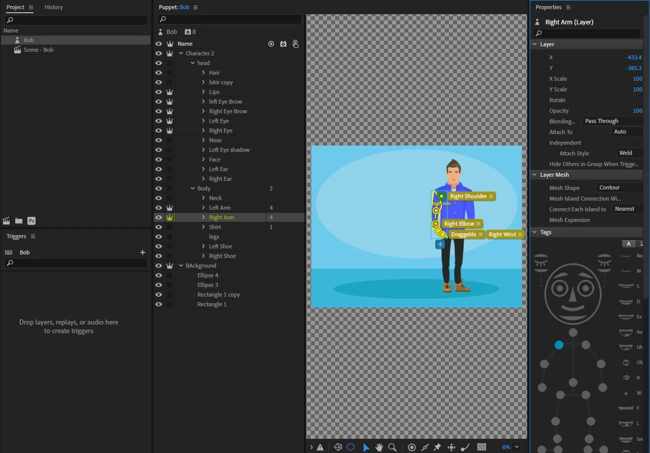

k_oshiro
Feb 15, 2021 11:33 AM UTC
I managed to move your puppet's head, but I fixed it quite a bit.
It's hard to explain everything in detail.
Main corrections
1) The layer structure has been simplified in Photoshop.
2) Fixed that the left and right layer names were reversed.
3) Divided into groups for each part
I made many other fixes.
Instead of making a complex puppet all at once, you can get good results by making a simple puppet and tagging it correctly.
I uploaded the modified puppet to Dropbox.
https://www.dropbox.com/s/wwbwv2rtun4fada/edit_The%20Real%20Bob.puppet?dl=0
thank you.

Feb 16, 2021 1:55 AM UTC
I'm so sorry, but one more question.  I'm trying to get his arm to move, but it's not working.  I'm following the steps on this video and it's about 15 minutes into the video.

Feb 15, 2021 1:53 AM UTC
I converted Japanese to English with translation software.
There are many possible reasons.
For example,
You may not have added a head dag, or you may not have erased the extra garbage around the head layer, making the head area larger.
If possible, let me export the puppet and share it on Googledrive or Dropbox.
If I look at it in detail, I may be able to figure out why.
You can export the puppet from
File -> Export -> Puppet
Thank you.
