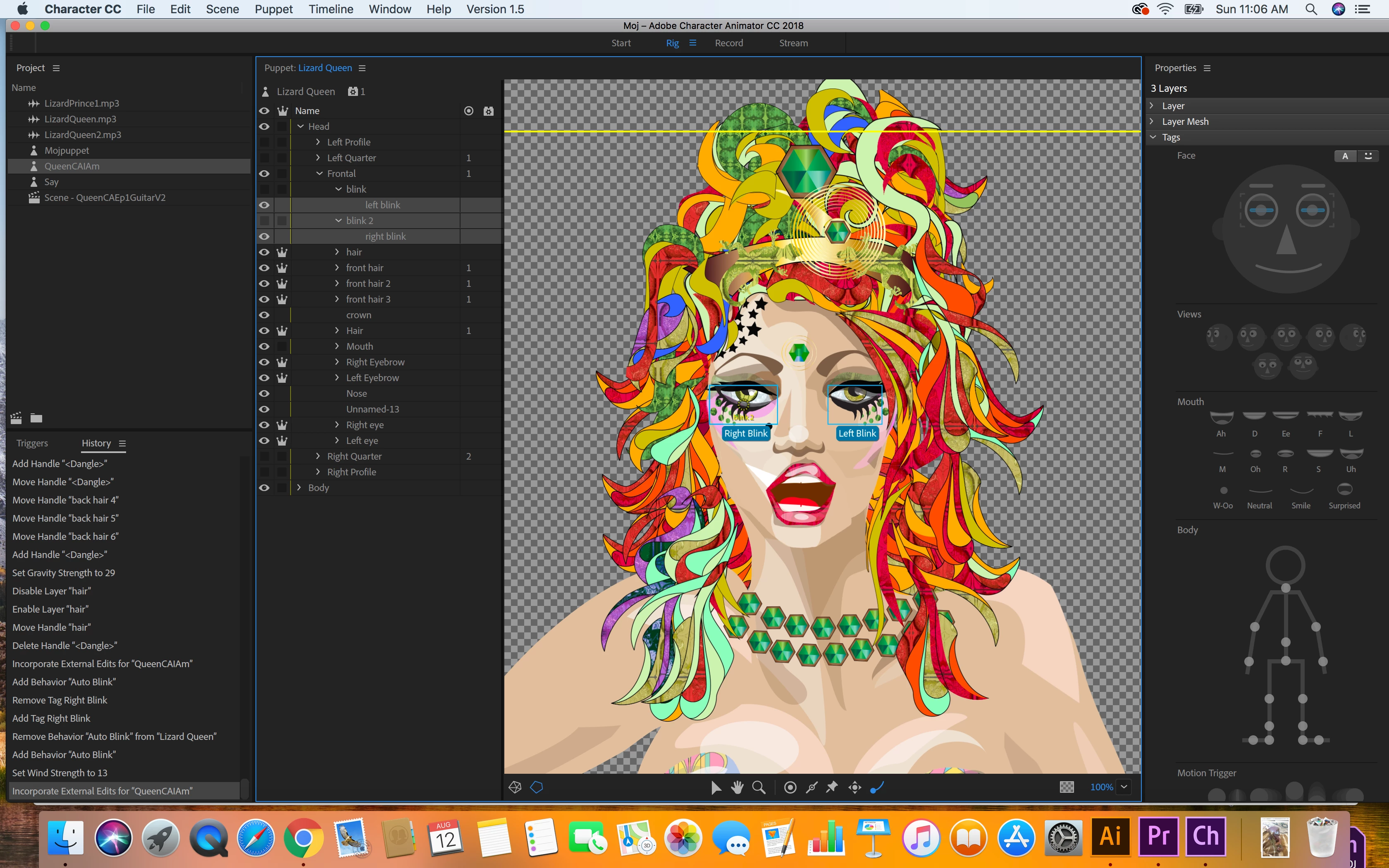

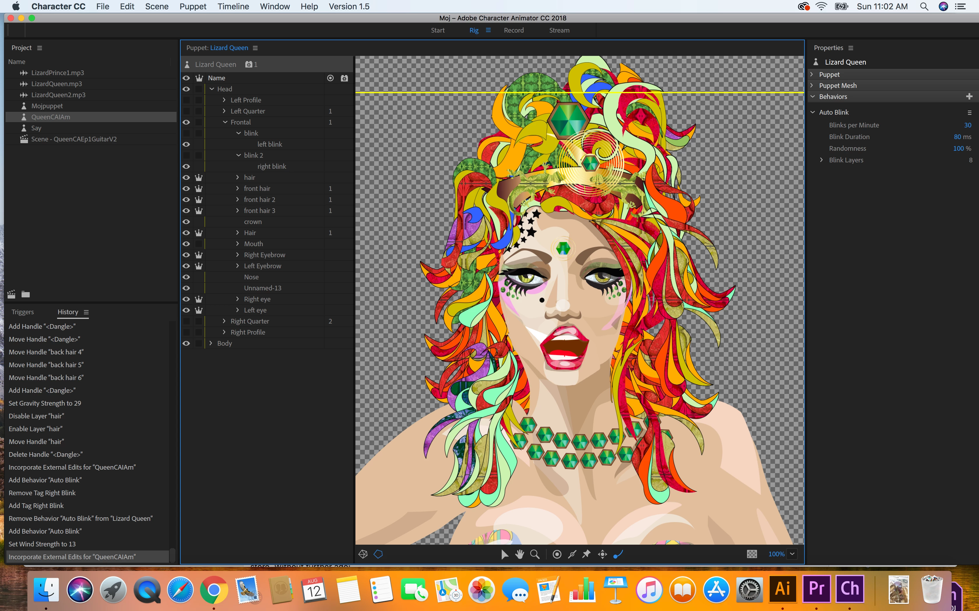

    House of Sugars
    Aug 12, 2018 6:54 PM UTC
    What am I doing wrong so auto blink isn't working?
    alank99101739
    Aug 12, 2018 7:47 PM UTC
    Two suggestions
    - you might need a blink behavior per profile (maybe)
    - but I think you have the blink layer in the wrong place - it needs to be under the eye layer to be a sibling of the eye parts (to hide them)
    Debugging Adobe Character Animator Eyes – Extra Ordinary, the Series
    House of Sugars
    Aug 13, 2018 5:24 AM UTC
    I didn't have the eyeballs turned on! I knew it was gonna be something dumb. Glad I figured that out myself!!!!
