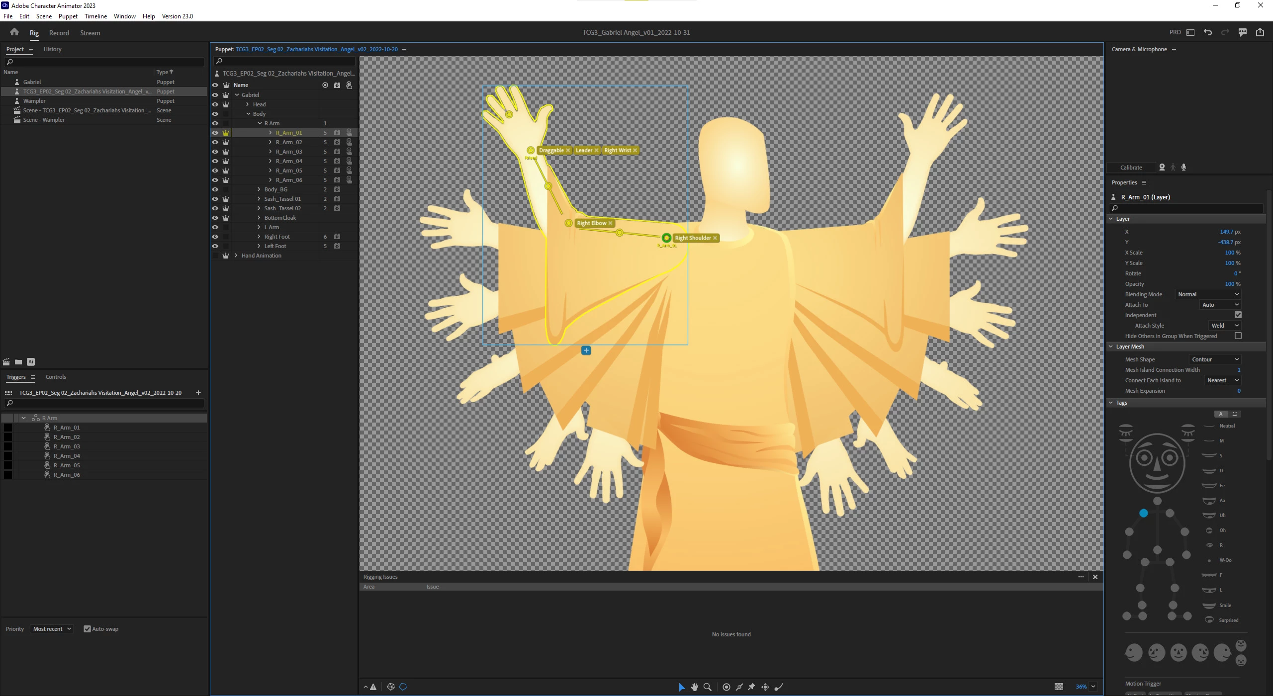

I'm working on this character where I have built 6 different layers to create a swap set. I had the character working with some nice dynamics using just the one arm layer but it not letting me move the arm and was clicking from the first layer to the last and staying there and not letting me move it. I removed the dynamics to help simplifiy it down to what I thought was the minimal amount needed based on what was done with the Wampler sample rig. Sadly I'm still I'm getting the same result.

Ok I realized what i did that was worng. When J was talking about the Behavors being at the top level I was thinking the top level was the leader object. Going back and watching the video from Ok Samurai I realized that I didnt have the behavors on the top level which is the main character group. Thank you all for your help in getting this together!

One thing I can tell just by looking at one screenshot of the rig mode is you have behaviors set at all arm layers.
You probably do not have to set it up with so many behaviors scattered everywhere.
If you look at Wampler available on the home screen, it has behaviors consolidated at the top level.
I am happy to take a look at your puppet if you are OK sharing a link to your puppet on Creative Cloud/Dropbox/Google Drive etc.
You can DM me the link instead of publicly posting the link here.

Last time I had an issue like that I had accidentally tagged all arms as leaders instead of a single arm as leader and the rest follower. Not sure if you have looked at that?
