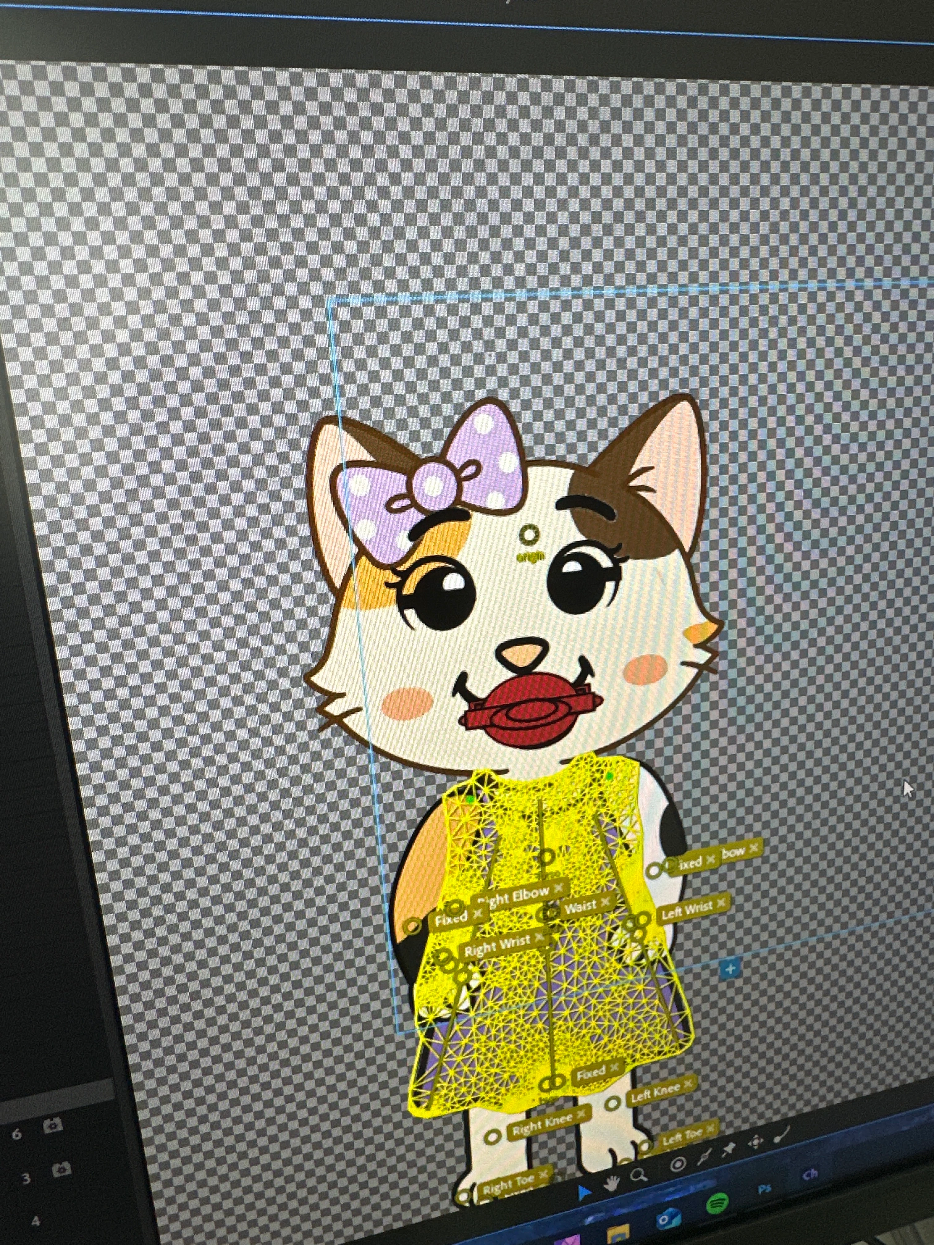

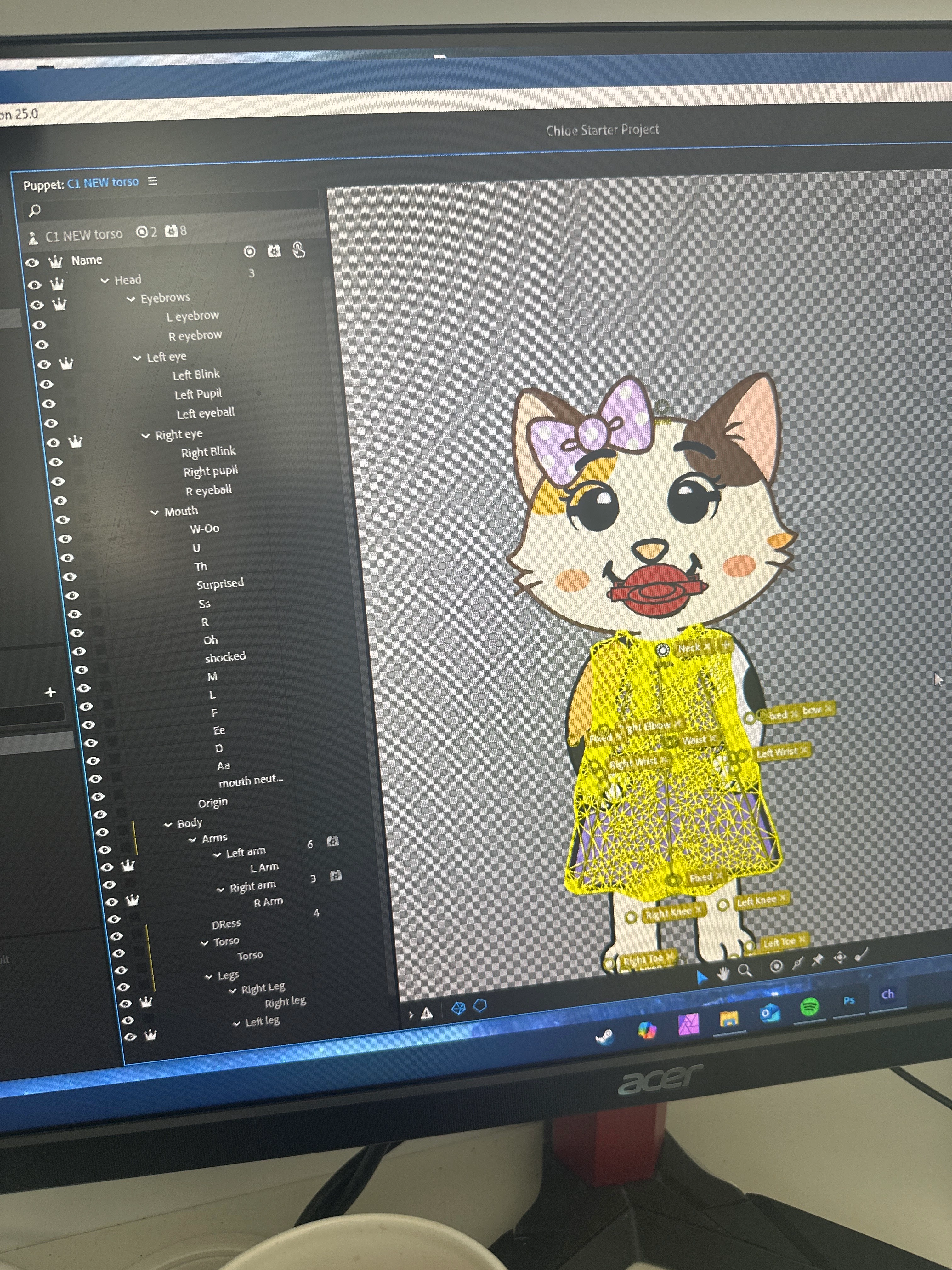

I see you have both eyebrows in one layer marked as eyebrows which is independent. Take each of the eyebrows out of that layer and delete it. Each eyebrow should be independent. Each pupil needs to be tagged as independent. Is the layer marked as "origin" the face? Usually, the head is not independent of the body. It should be attached to the neck, but I don't see that in your puppet. Please verify thet the origin point for the head layer is where you want the head to pivot on the puppet as shown in the image below.
Jun 27, 2025 4:55 PM UTC

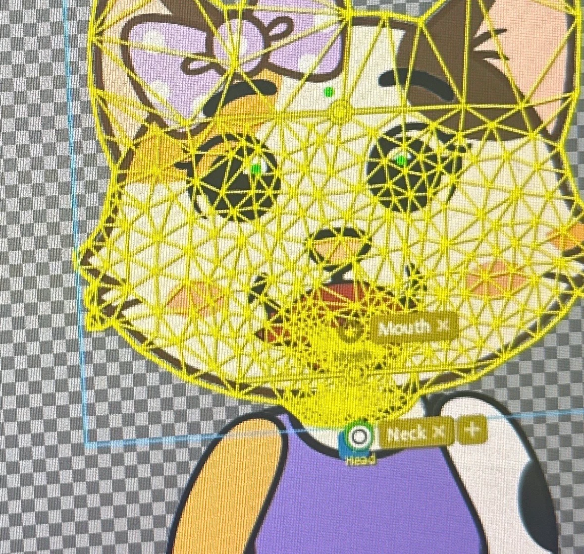

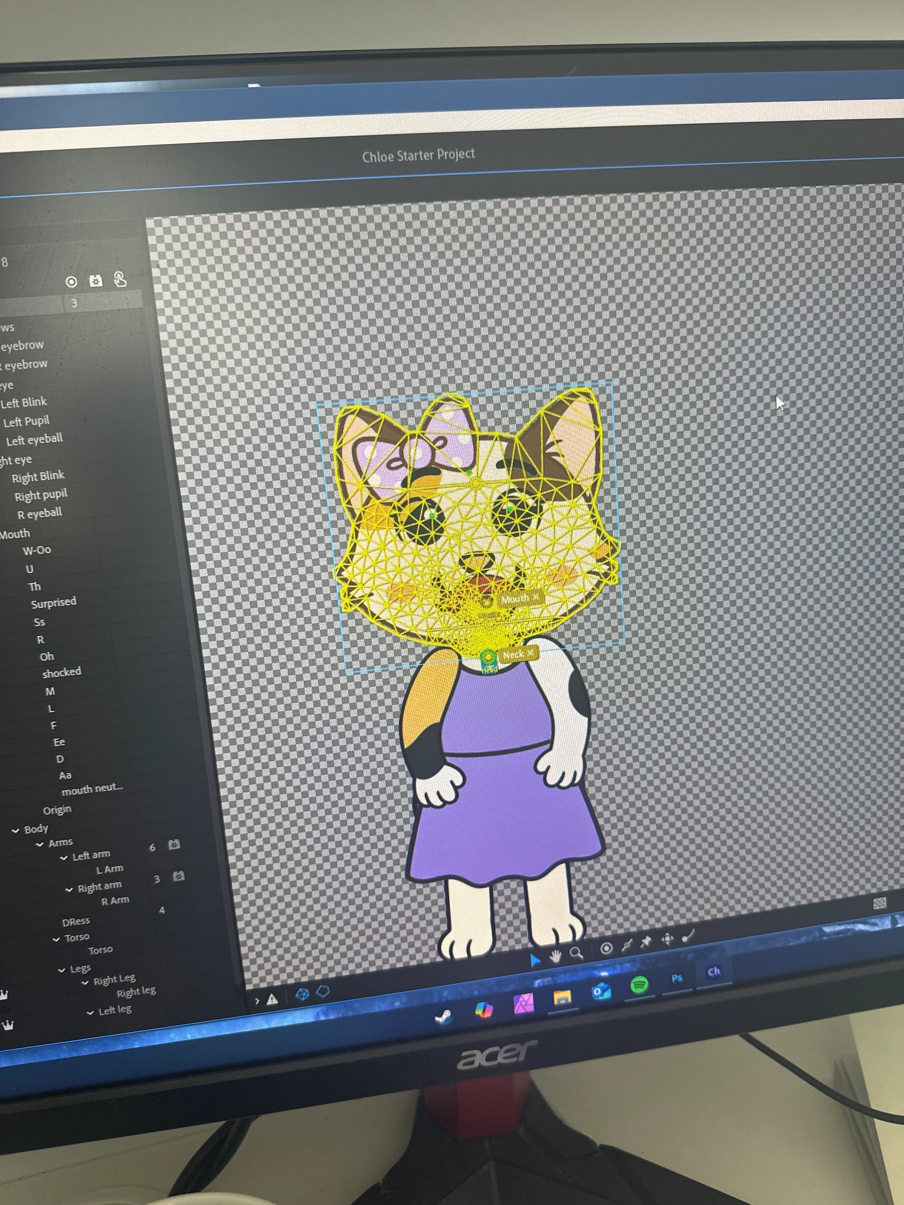

Thankyou so much for your reply. I will sort the eyebrows out! The head is named as original on my layers and as you should be able to see on the pic the crosshairs point for the head is exactly where I want the head to pivot at the join between head and torso, iv also added a handle on the torso layer and tagged it as neck and placed it directly on top the head so they are in alignment. But the darn thing still falls off if labeled as independent and if not crowned then it's fully attached and won't move at all. This is my first puppet iv created and I'm worried iv missed something 😂
TheOriginalGC
Jun 27, 2025 7:15 PM UTC
It's hard to tell with the filled mesh in your selected image, but it looks like there are a couple of sticks placed in the head. Why are those there?
Yes, if the head is independent, then there's nothing to connect it to the neck, causing it to float. Would I be correct in assuming that when the head is attached to the body, then the body swings whenever you try to move the head? If so, try adding a stick to the base of the body and give it a "fixed" tag to pin the feet to the ground.
