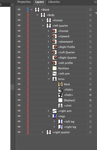

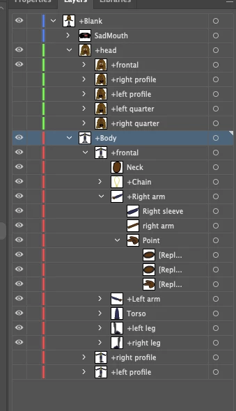

Character won't walk or drag, used to be able to
I am learning how to use character animater, so these are my first characters. They were based on a template then changed. I added behaviors and rigged them to walk, turn, and have swap sets but now none of those behaviors are working. Please help!!

You cant really tell anything from illustrators screenshots, you would need to show CA screenshots. Did you check to make sure all tags are correct? Did you confirm that the rig has 1s in the relevant panels? Need far more information in order to help or make suggestions.
alank99101739
Mar 25, 2020 6:00 AM UTC
One thing to be careful of is to not use too many indepdence layers. I noticed a lot of "+" symbols (make independent). E.g. alarm bells go off when I see "+Body". You need to have something in the root mesh for other things to attach to. The most common approach is for Body to NOT be independent, then it merges into the root puppet mesh. That gives the Head something to attach to. Also the profiles seem to be head turn profiles separate to body walk profiles. This should work I think, but I don't see that pattern very often.
I suspect you either want "+Head/Frontal" or "Head/+Frontal" but not "+Head/+Frontal" as there will be nothing in the Head layer for Frontal to connect to.
