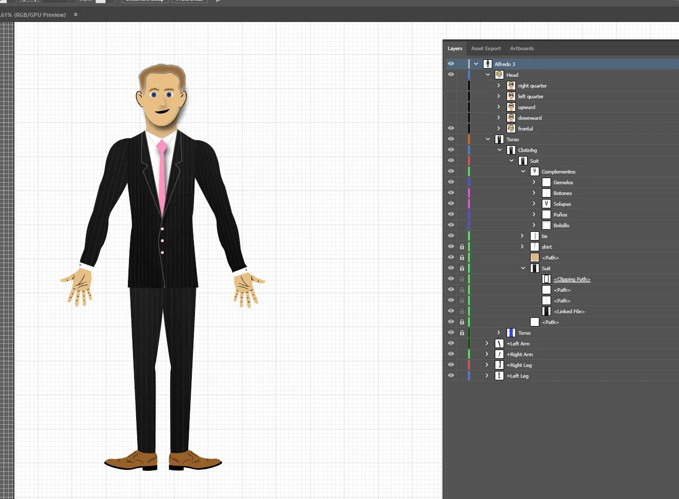

So, I have made some clipping masks in illustrator and taken then to Ch without problems(clothing, basically). It gets the clipping group as a single layer, and fine. But I have two arms in wich it is not working. Actually, three, but one got solved just recomposing layers in illustrator. I have tried the same, but it does not work: it gets it as two different layers and therefore the <linked file> in illustrator appears completely, not being the inside of the clipping path. I have tried renaming, reordering...i can´t make it work. Any ideas? Thanks

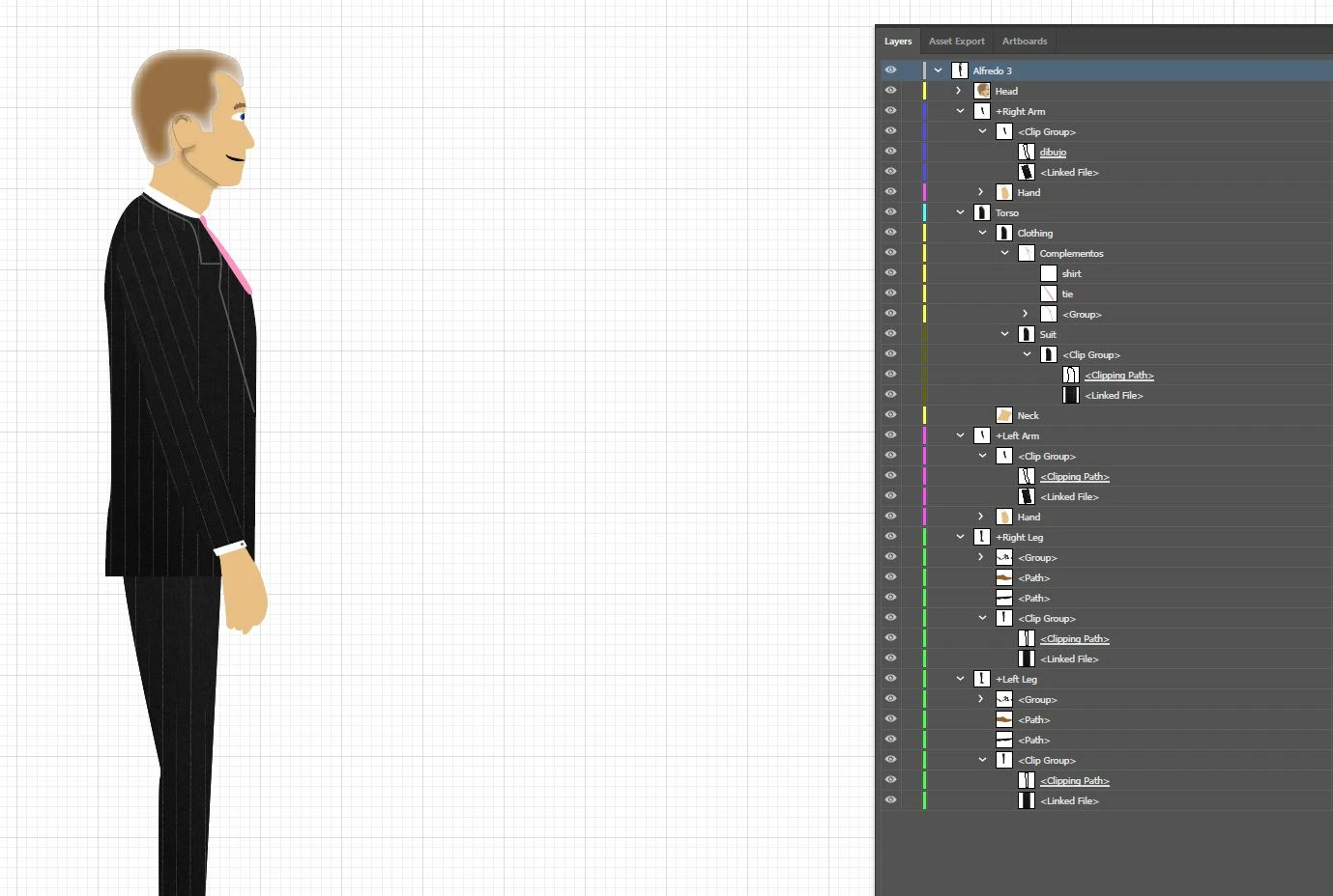

    Looks like you may have figured it out, but here's a small project showing the clipping group in AI *not* being supported in CH and an alternate way of structuring the puppet so that you can get the same results.
    https://adobe.ly/39DZFuP

    Basically use the pathfinder tools crop mask instead of a clipping mask. This will then "cut" your shapes to the size of the clipping mask. Meaning it follows through to character animation with no weirdness!

    Sorry, I don't understand your description, but I thought that Illustrator clipping masks were not understood by Character Animator. It just understands the transparencies in Illustrator files. There is a clipping mask concept inside Character Animator you can turn on, but I suspect you are not using that from your description. Could you share a screen shot perhaps?

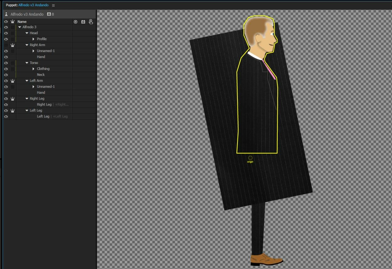

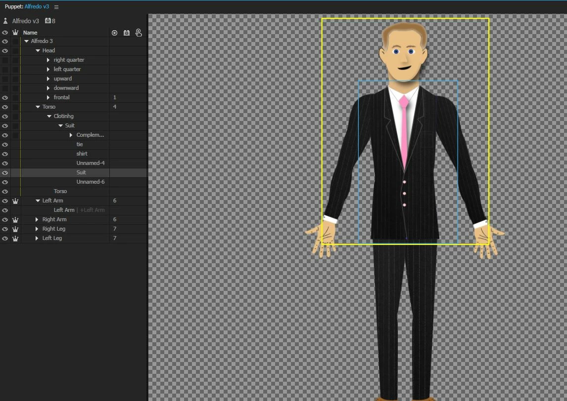

    Thanks! Maybe I am just getting lucky with this clipping masks??? As you can see, clipping mask are interpreted as one layer in my frontal character, while some are interpreted as one layer in the profile and others as two layers(being a problem). I hid the right arm in the profile character so you can see the torso is alright, but the arms are not working.

    Ah, gotcha!  Character Animator tries to auto-detect the outline, but sometimes fails. It is usually because there is some discontinuous object in the layer. There is a property that you can set to “Contour” to force using the outline instead of the default “auto”. You could try just setting that.
    Otherwise (or as well!) try going into AI/PS, go into isolation mode for the suit, then try using the laso tool around the suit to see if you can highlight something that snuck into the wrong layer.
    The other thing to try is clicking the little mesh icon at the bottom of the “rig” and “scene” windows. It shows the mesh it allocated to the layer. This is very important to get right otherwise things will distort badly later. Sometimes it highlights the area that is wrong (the mesh looks funny around a point you did not expect).
    Regarding artwork quality, looks good to me! I am a programmers with zero formal art training, so I cannot speak either! ;-).  As long as its fun, who cares what it looks like... which I can say since this is a hobby for me, not work.
