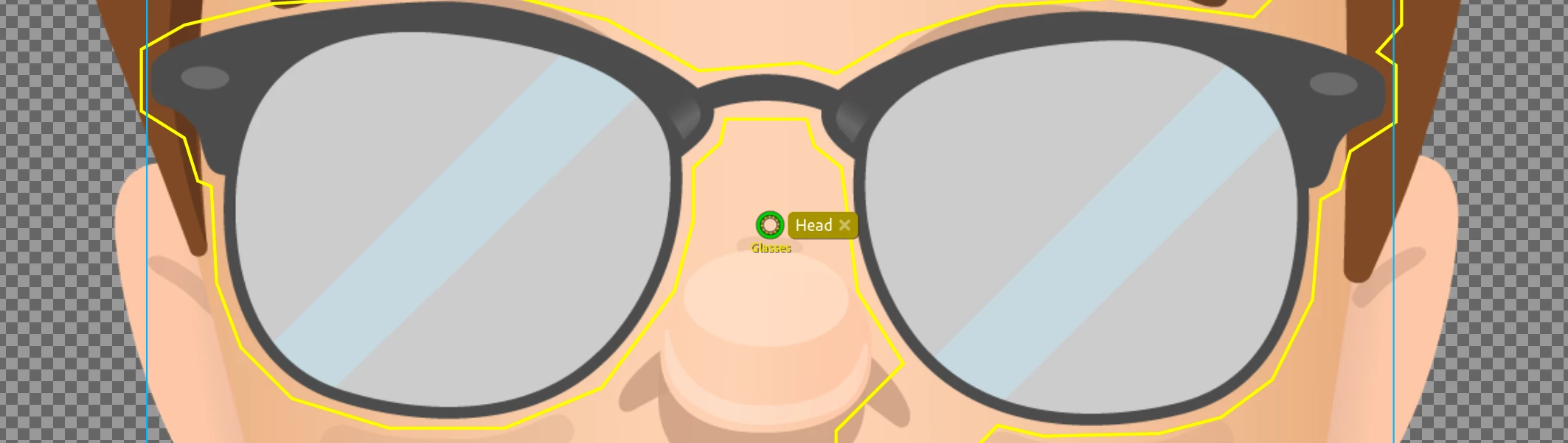

I am trying to create a clipping mask for some glare on these glasses.
Is this possible? It seems the mask needs to be a solid color and I'm not sure
how to use the clipping mask without being a solid color.
This is one solid gray color shape behind the frames.

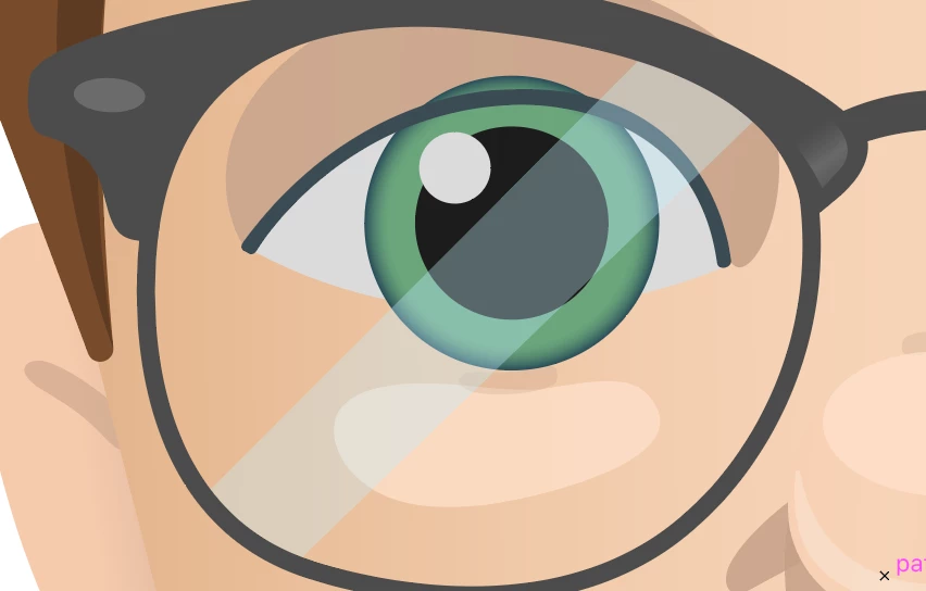

My setup here.
How it should look here in Illustrator

    I am not quite sure what you are trying to achieve. A clipping mask is to crop according to another shape. Do you just want a transparent layer in front of the eyes? That is, do you really need clipping? Or do you just need a fill area that is semi-transparent?
    Having said that, I have no idea if CH supports transparency in a mesh! I have never tried that.
    But also note, the clipping mask I think uses *all* following layers under the same parent. So you might need to have “Right Glare” clipped by “Right Glasses Mask” and “Left Glare” under a different parent with “Left Glasses Mask”. I don’t think it will work having Right Glare clipped like that - I think it will be clipped by the left glare *and* the mask.
    Are you trying to just draw a diagonal rectangle and clip it by the shape of the glasses? I tend to use layer subtraction instead of clipping in CH. Clipping in CH I use more for moving thens - e.g. is the glare moving on the glass surface?
    But clipping does not support transparency - it is a hard clip (show or hide).
    Bottom line: not sure I answered your question as I was not 100% sure what you were trying to do.

    Hey alank99101739​
    Thanks for your help detailed help.
    I wanted to have the glare do a parallax move as the head moves back and forth
    so I wanted to use the clipping mask to make sure that glare did not go outside
    of the glasses frame.
    I might just be able to get away with out the clipping make an make sure the parallax
    moment is not too big and the shape stays within the frame.
    Mike
