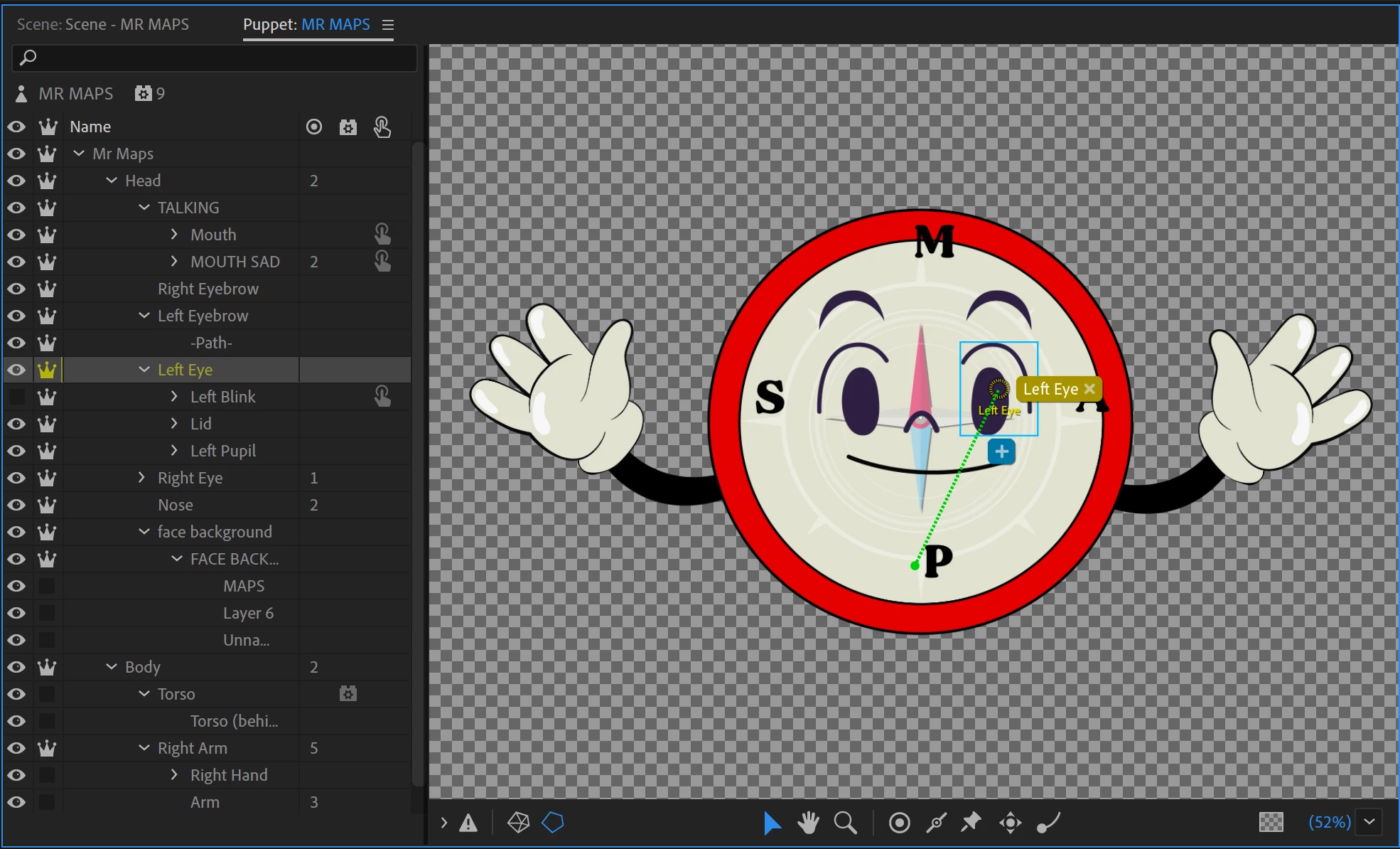

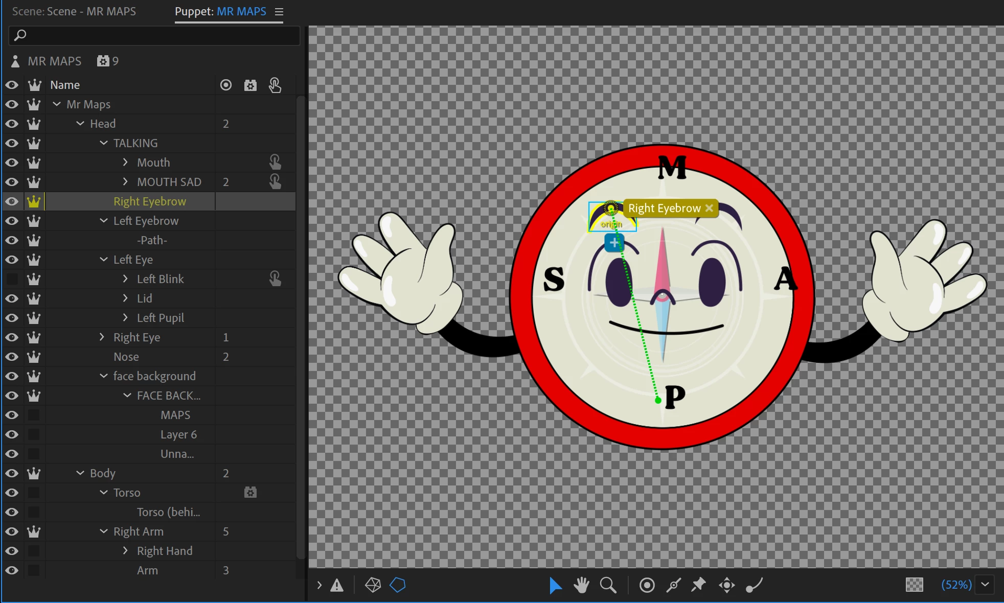

Hi! I am having trouble rigging and making a character with just a head and arms.
I followed many tutorials to try and rig but right now my head moves alone. I tried to follow the character footy but I am still a little lost.
This is my character, I call him MAPS

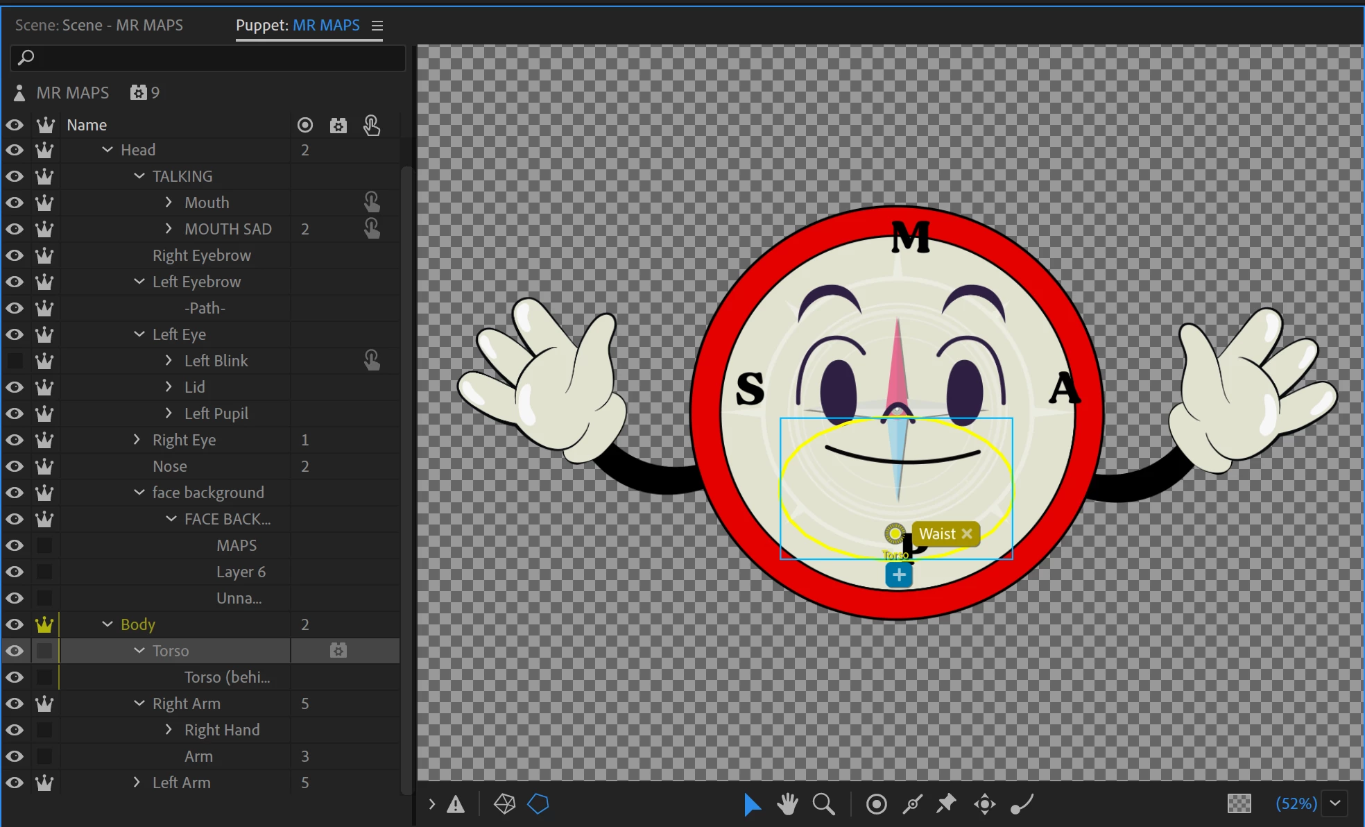

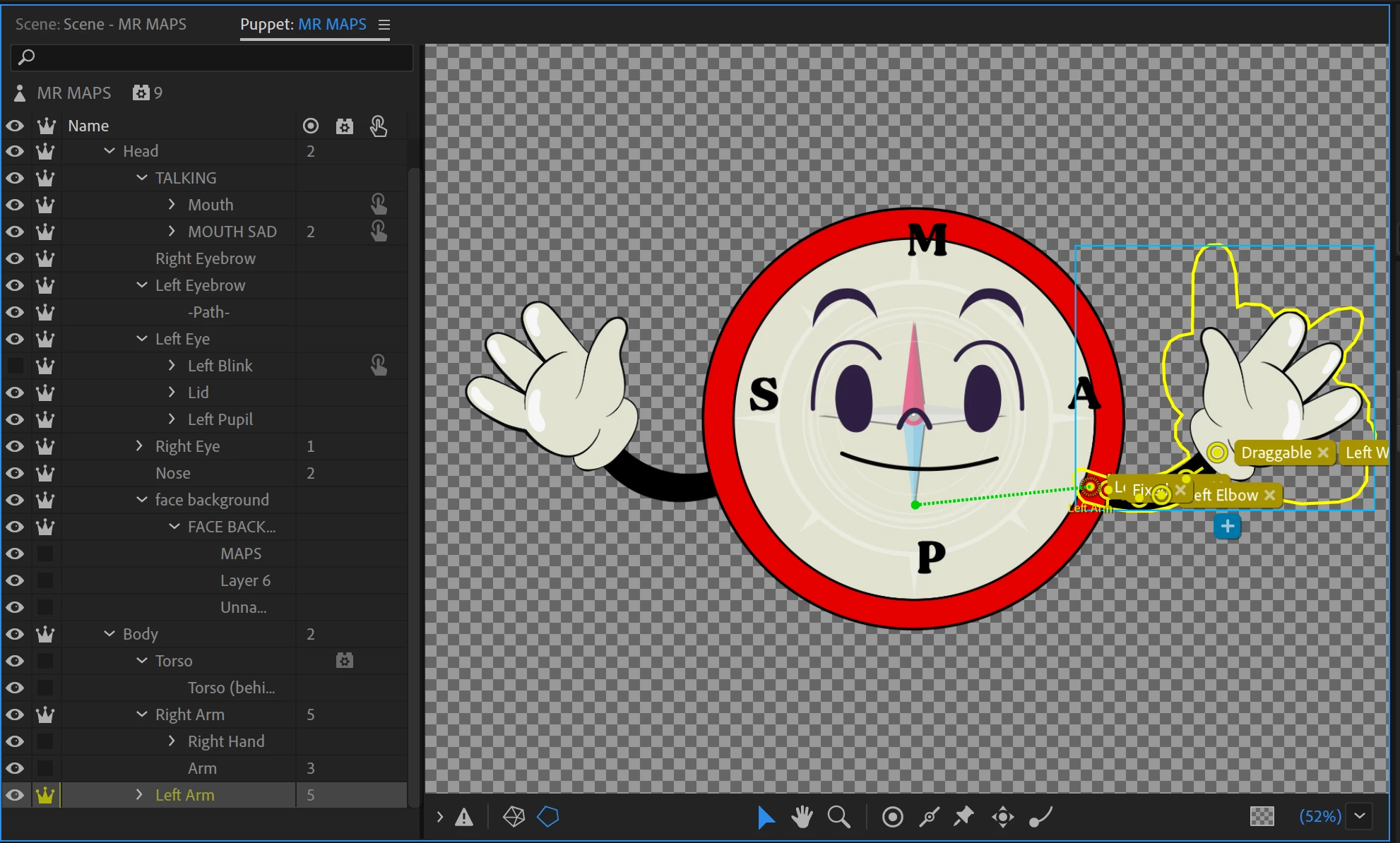

I also added a hidden torso but nothing is connecting together and the head keeps moving off.

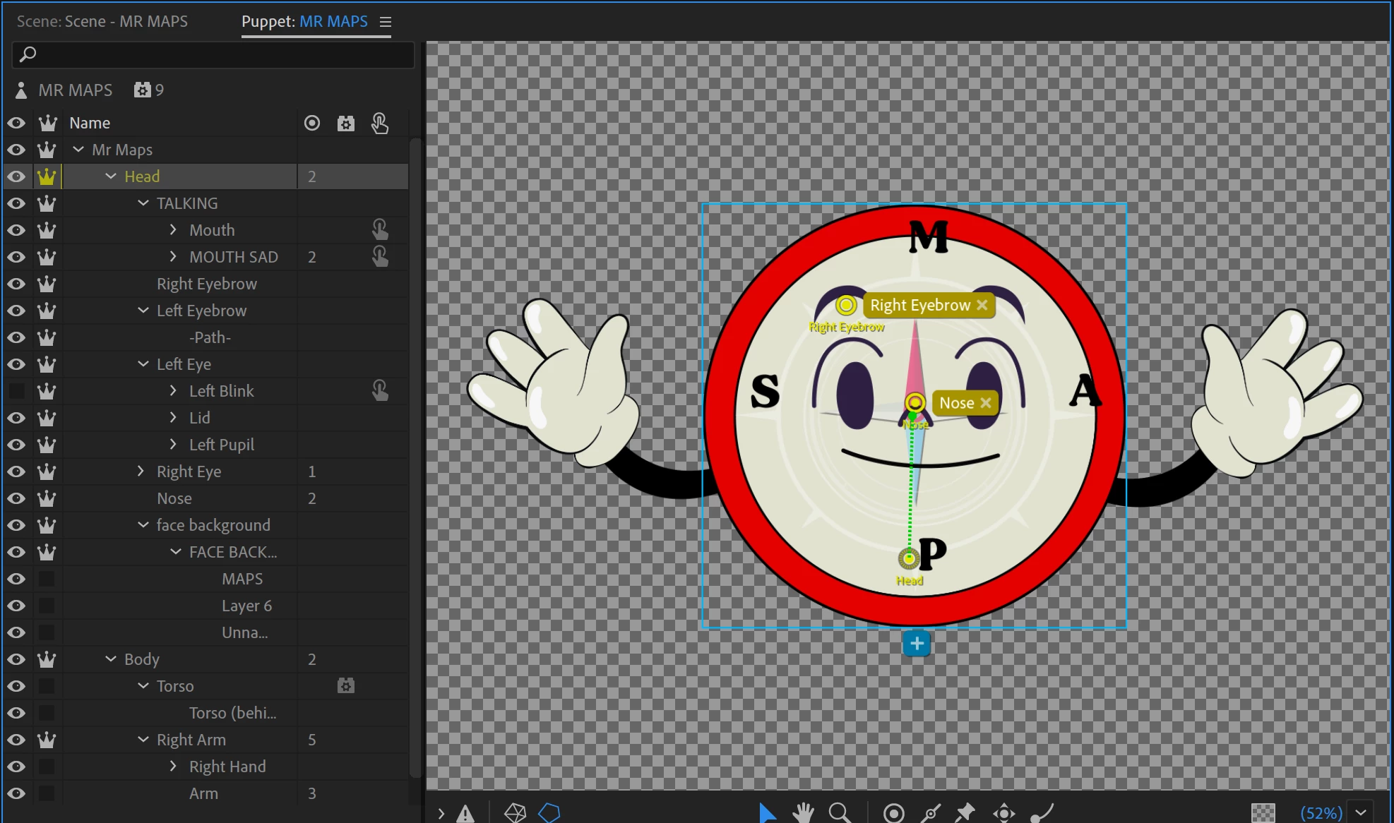

This is how I have rigged them
 Please help! :")

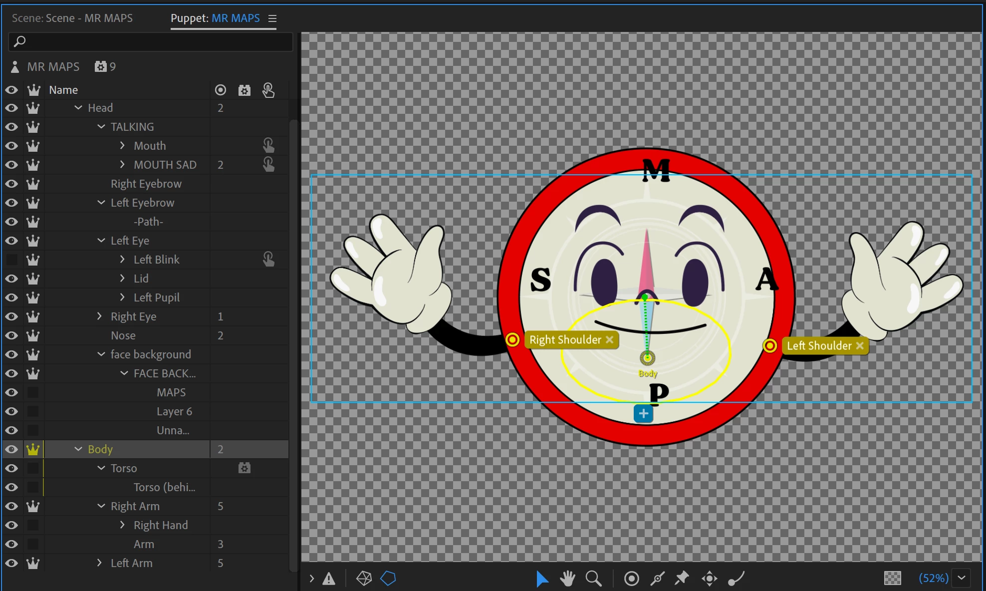

Hi, I'd try removing the independence from both the head and the body and see if that helps.

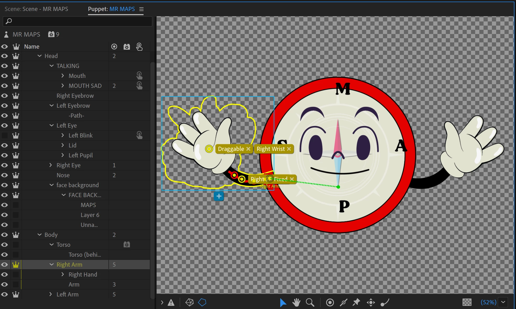

I noticed that you have the right shoulder (and presumably the left shoulder) fixed. This "nails" the part to the stage to keep it from moving. The first thing I would try is removing those tags and see what happens. I do not know how much you need the head to be moving, but if you need to fix the base, I would create a handle for that region and apply the fix tag there (possibly the torso as well.)
