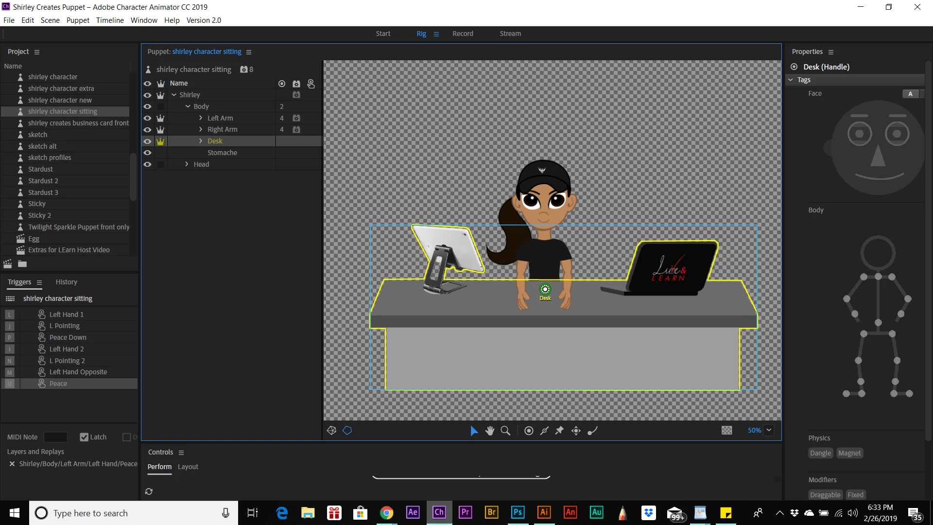

Hey guys!
So I've created my own puppet based off of the Almasol Podcast puppet structure. I matched all of the layers in PSD in the correct hierarchy and the +'s all seem correct.
When I open in CA everything is working except for the desk, it's moving around with the camera input. I've added a fixed point and stick in the body layer of the rigging so I'm not sure what I'm missing. Attached I have some pictures so you may be able to catch whatever it is that I've overlooked.

shirleyl41183719
Feb 27, 2019 12:42 AM UTC
Alrighty, so I tried all of the above with the same results. The "Free" was actually making it worse and made it move as it had been at the beginning with the camera input.
But!! I played with the origin points and put them directly on top of the default point, if that's what you call it, attached I have a picture of what I mean. I had to change that on the Desk and Shirley layer. I also tweaked the face settings slightly and now it's not moving!!
Thanks for all of your help! Now I just need to figure out how to make her neck and not so much her body.

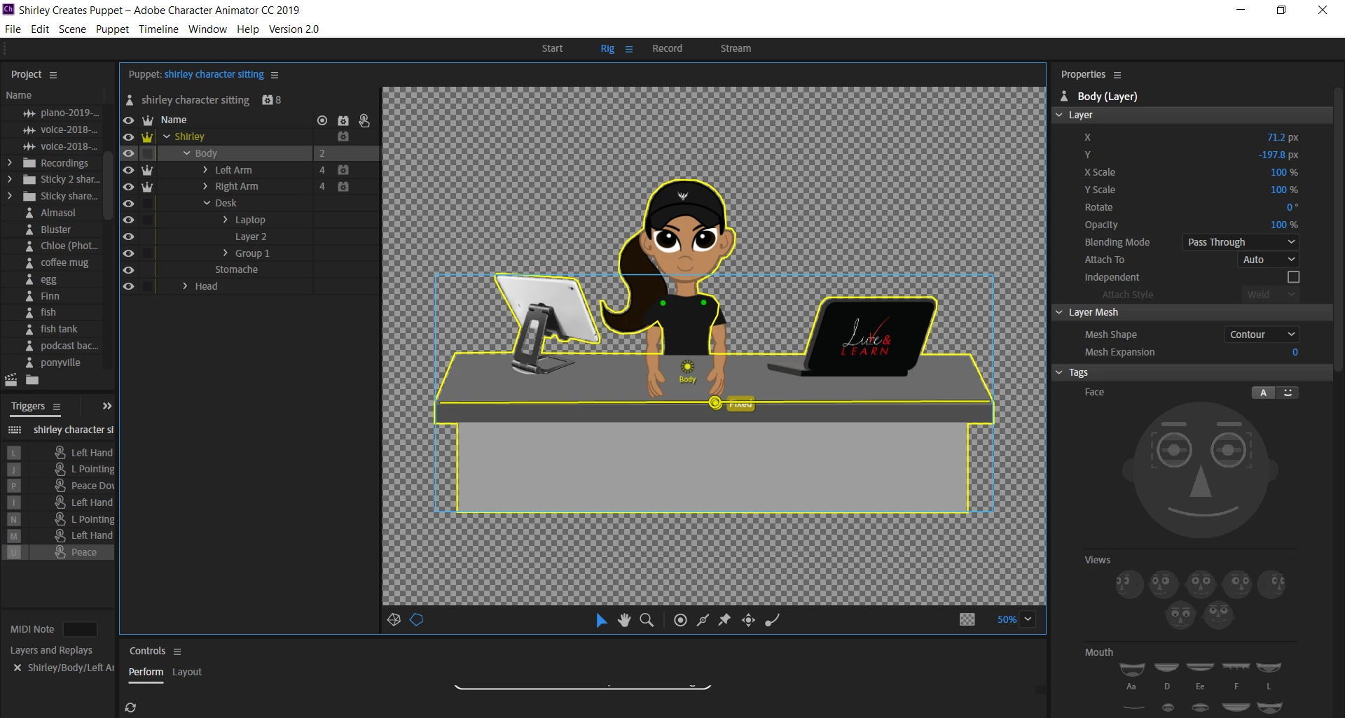

shirleyl41183719
Feb 26, 2019 3:24 PM UTC
Thanks for your quick reply!
So I made the desk independent and used the "Hinge". It's working much better than before and isn't moving around as freely, however, it's scaling big and small now, almost like squishing itself if I move the head. I tried using a fixed point and stick on this layer but still have the issue.
shirleyl41183719
Feb 26, 2019 3:31 PM UTC
Here's what I mean, it's stretching and squashing and floating somewhat.
