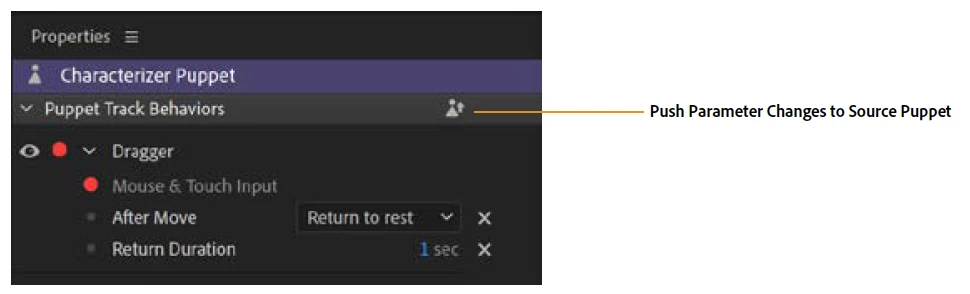

     Ok so after checking documentation I found the "Push parameter changes to source puppet" button which I couldn't see as my properties panel had been scrolled down, and I believe this is exactly what I was looking for. I can't seemingly delete the topic so I hope this post helps someone else who has a similar issue. Thanks anyway!
