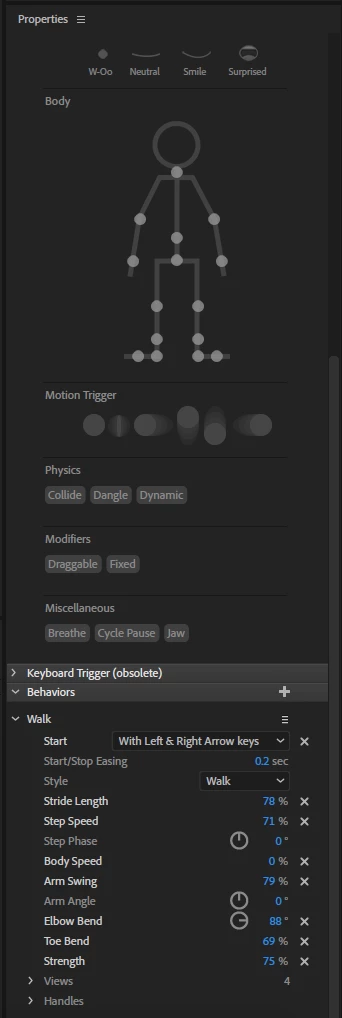

Duplicate walk behaviours in puppet properties.
In my new puppet that I built from the ground up is showing up with 2 walk behaviours. One from the root menu (which works) and one from my character scene (which does nothing).
I think this is causing my puppet to distort in the leg movements and the arm swing only swings in front of the body.
The legs appear to be doing away from the scene and adjusting rigging in the leg does nothing below the knee.
              This one is from my root properties                                      This one is when character is in a scene

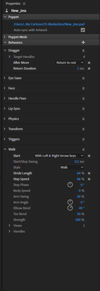

Well, you only need one walk behavior, and either one should work. I tried your setup and it does seem that the root puppet walk disables the scene walk. So I would advise removing one of them. I'm puzzled why the root behavior does not show up on your list of scene behaviors. When I tried it both behaviors are there.
As for the leg distortion, I'm not seeing any affect with two walk behaviors. My first guess it is something to do with the rigging  and walk parameters. Remove one of the walks to see if there is any difference.
