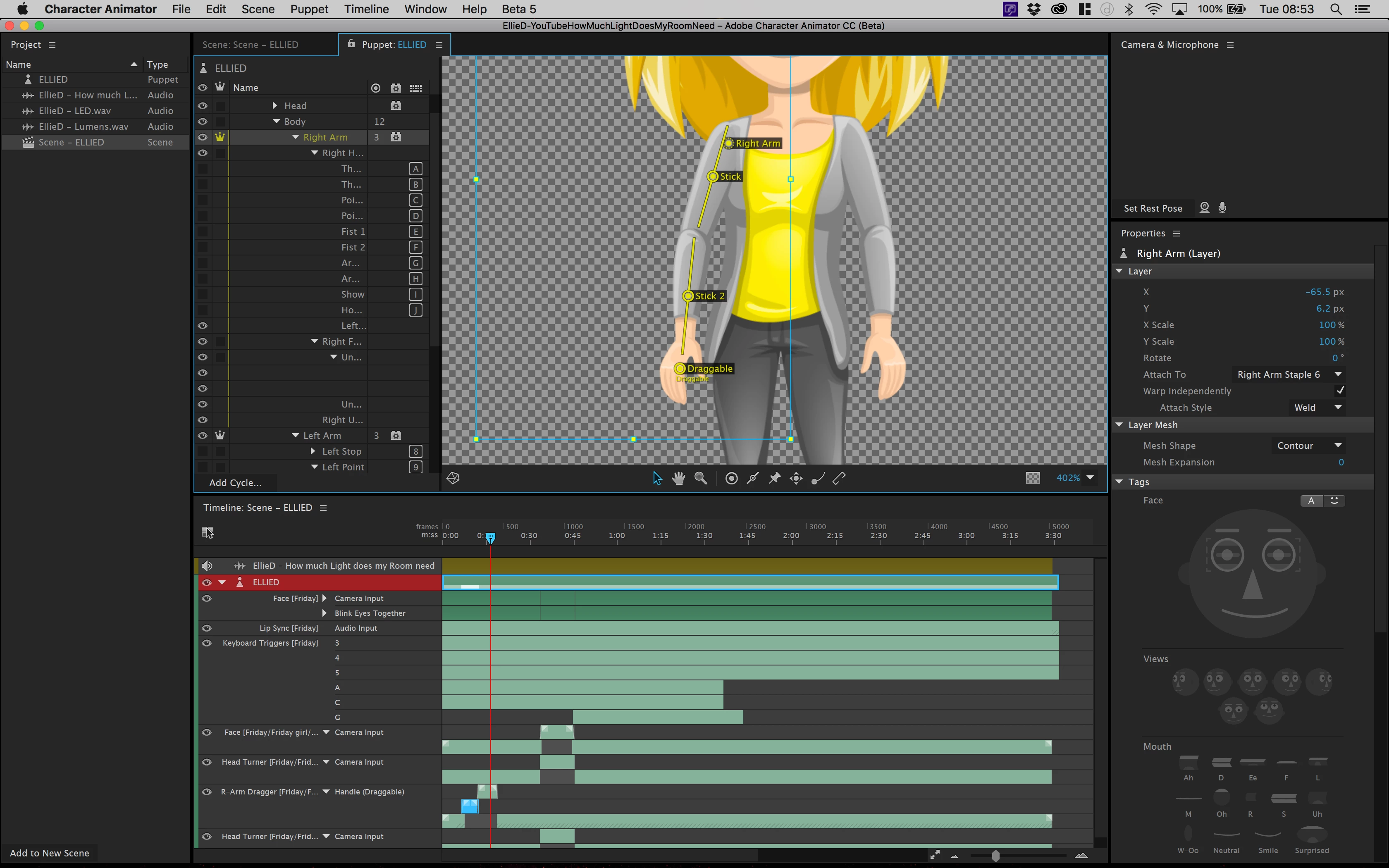

    Does your puppet use sticks to add rigidity to the mesh?  It would be helpful if you could direct message me a link to your puppet in order to evaluate the result.  Or, a screen recording of the problem?  Thanks.

    Jim, Yes I have sticks employed in the arms.

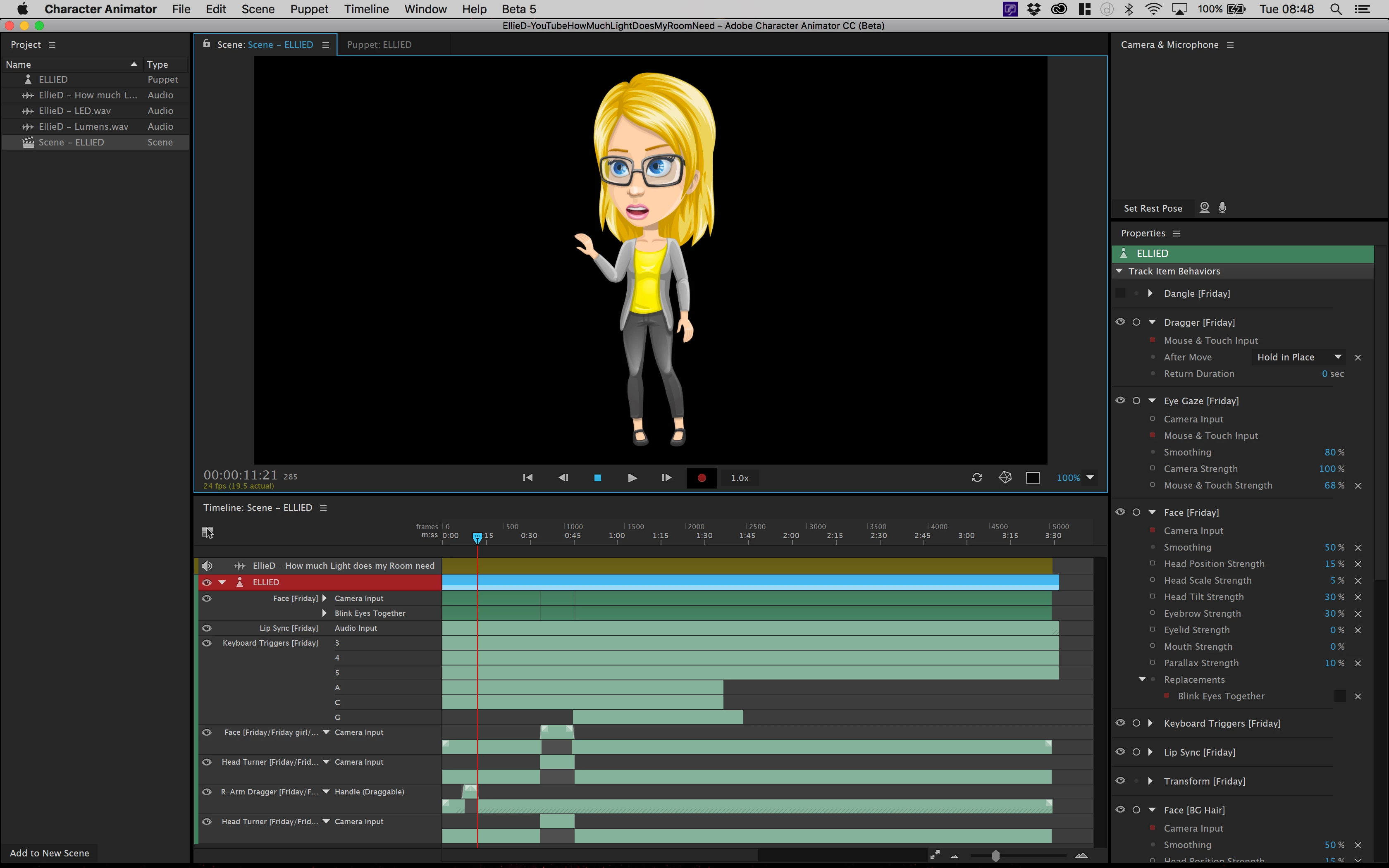

    During Positioning / Record:

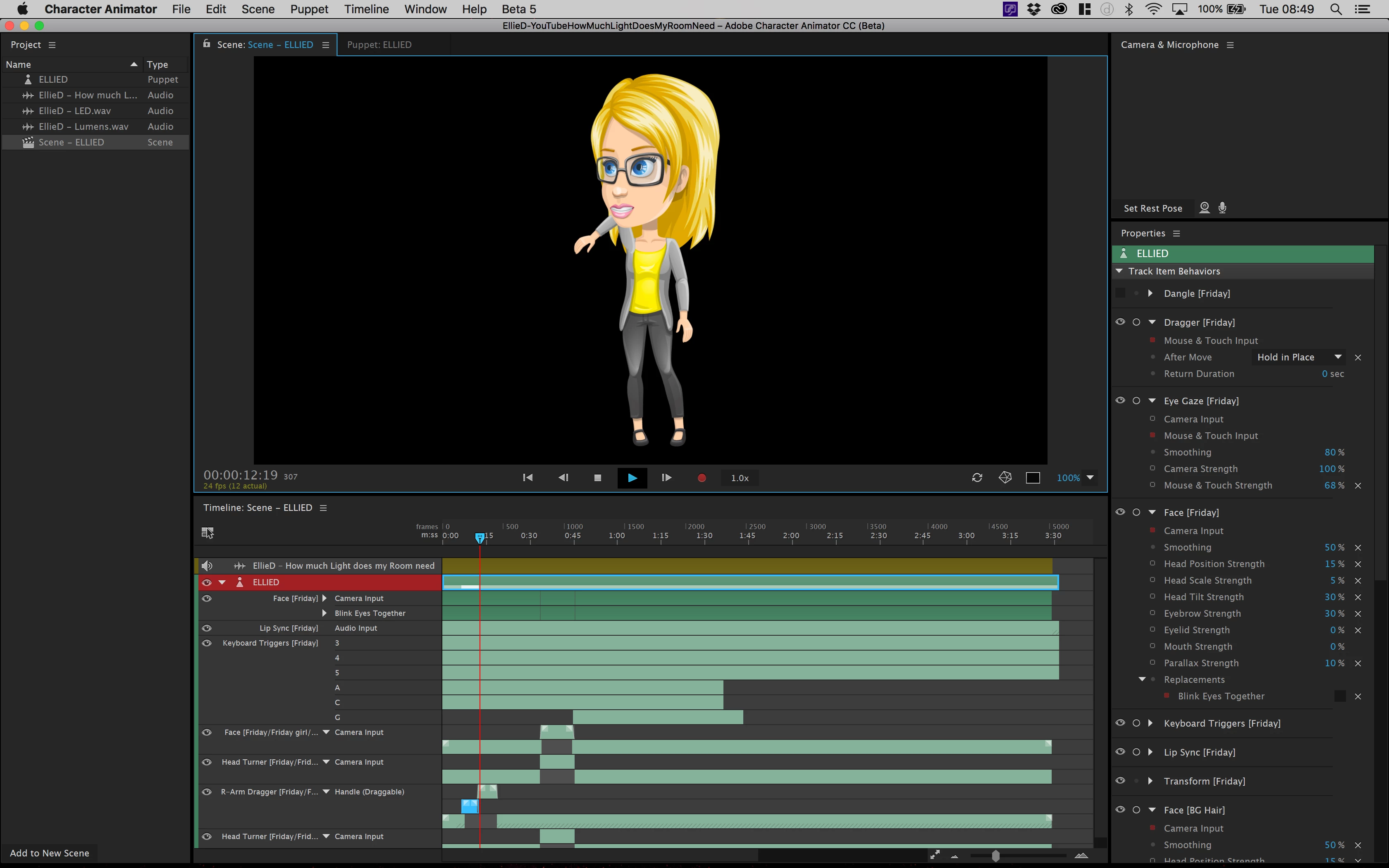

    During Playback:
    Any help you can offer would be appreciated. Most confusion and frustrating!
    Glenn

    One thing you can try and this is with the caveat that I consider it a workaround and not a solution is to put a draggable handle on the elbow as well so its position will be fixed by the recording instead of determined by the behavior runtime (which as you noticed here can result in different results from the original, unfortunately in this case). That does mean more manual positioning work as well, so again, it is just a workaround.
